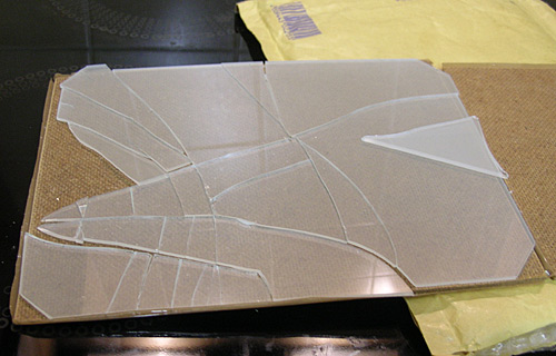

ARRGGGHHHH!!!!!!!! Gotta say that the package looked great and felt great, but when I got past the padded bag and cut the edge tape, the GG was broken into many pieces. :sad: :mad: I generally stick up for the Royal Mail when they get a hard time, but on this occasion they've come up as zeros rather than heros.:sad::sad:
Still can't thank you enough for all your time, trouble and effort on such a generous gesture David, so name your charity for the donation as they shouldn't lose out because of the PO. And many, many thanks once again!:smile:
Peter

I've bought a few screens (5 or 6) before I started making my own and despite far longer journeys US/UK all arrive unbroken.
David, I looked at your packaging and thought they'd break. The glass needs to be between foam or something then the more rigid packaging. I actually have a box that contained a 10x8 screen and you could throw it around and the glass would be difficult to break because the shock is absorbed.
You need board / foam/ glass / foam / board then a Jiffy bag, the foam for my 10x8 is about half an inch thick.
Ian

Ian, thank you for the information - I'll definitely be taking note of it :smile: I had thought that the hardboard would prevent flexing of the glass and the jiffy back would absorb the shocks received in transit. How wrong could I be?
Peter, I'm so disappointed - for both of us! I'll make you a new one over the Xmas period and send it in the new year. This time, I'll heed Ian's advice and you should receive it in one piece! As far as charities go, it's really up to you, but a cancer charity would be nice as I lost my grandad to cancer a few years back.

Hopefully there is a digisnap of the ground glass attached to this mesage, but it's the first time I've tried it, so no guarantees. I'm thinking it may have been stressed at a point about 1/3 in from the RHS and 1/4 down, possibly from something jammed hard against it in a bag, but that's just a guess.
While I'm really grateful for your offer to make another one, I can't have you going to that trouble again for me, and you've already done more than anyone would have a right to expect! I still have the original GG, so maybe someone else has a greater need than mine.
Hope this works, Peter
