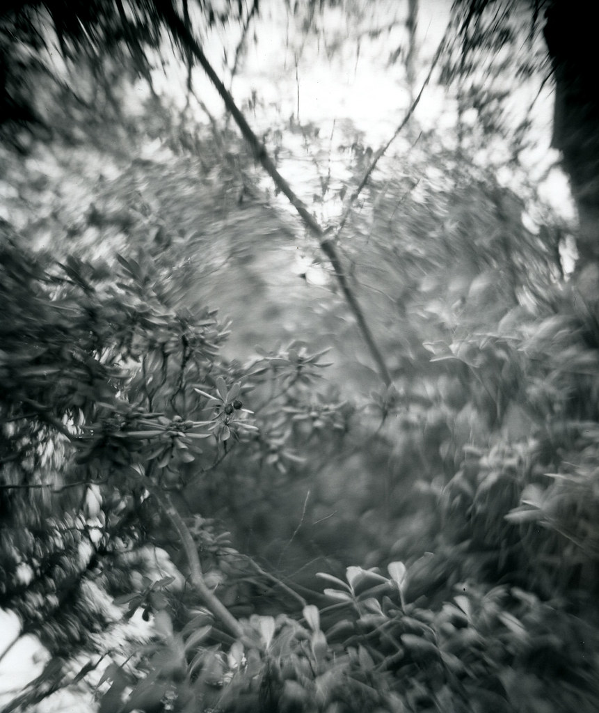

As some of you may recall, I've been messing around with making my 'own' lens. The original threads can be found here:
Lens - (there was a url link here which no longer exists)
Shutter - (there was a url link here which no longer exists)
So over the weekend, I took the temporarily assembled lens out for a test - to be sure it was what I wanted before I began cutting metal.
Here's the negs. Note however that when going ghetto, ghetto is all you can go.....My scanner doesn't play well with Linux, and I have yet to bother to purchase one that does (I had ordered a 4870...But after getting one that was DOA, I discovered that Epson isn't the best company in the customer service dept) . So....In a disgusting gesture, I have placed the negs on my light table, photographed them with my digicam (ca. 1999), and inverted them. Please don't judge such things as exposure and contrast, as its impossible to see. Also, be take notice of relative sharpness, not how sharp it looks on screen. One of these years I'll get a scanner and do it right.

In the other thread, I commented about how the distortion seems to be dependant upon bellow draw just as much as it does on the aperture. You can see what I mean by looking at the f/5.6 shot (closer than infinity), and then looking at the f/11 shot (infinity).
Thoughts ?

The astigmatism is - amazing!
And yes, I would expect that to be dependent on both bellows draw and aperture.
I've just developed my first shots with a "periscope" lens - two simple meniscuses (meniscii??) with an aperture between. I was very suprised by the sharpness and evenness of a 200mm (appx) on 5x7" film. Nothing like the astigmatism you've got!

Thanks Ole. Do you have any scans ?
Surprisingly, the lens is pretty sharp (believe it or not..). In the neg, the bark texture on the 'Y' shaped tree in the last shot is *slightly* visable. Even on the wide open shot, the leaves and texture on the bush are clearly visable

Cool, swirly stuff. Make a portrait and print it, borrow a flatbed scanner and show us the beautiflful swirliness! I like the f/3.8 and f/11 ones. Do you have flare issues (especially at f22) or is it just the unmentionable thing from 1999 that makes it seem so?

I don't think I have flair issues....Its just the negative-computer issue that caused all kind of stuff to show. Mainly, its just uneven illumination from the light table.
Im not going to take any more photos with it until I have the lens barrel finished (as I took the lens down to the shop last night). Once that is complete, and I make up some real stops, we'll see what happens.
