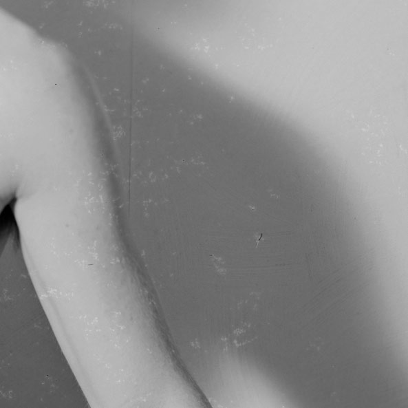

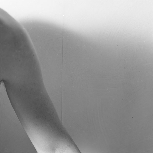

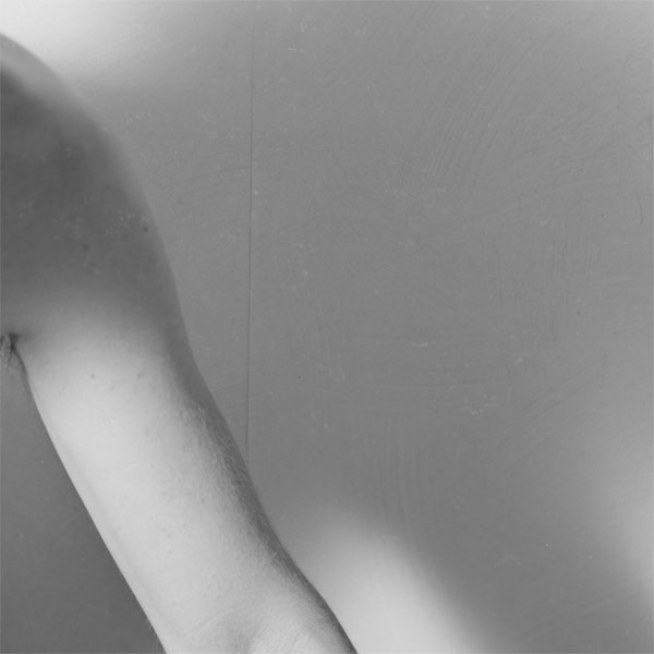

I'm developing in the Rollei LC developer, using 1+5 dilution and a agitation of 15 sek / 3 minutes. Developing time for EI 12 was 15 minutes, and EI 6 12 minutes. I use a water stop bath, Ilford Hypam fixer at 1+4, Kodak HCA, and final wash using Ilford wash sequence. This is the same procedure I use for all my films.
Clarification: these are 4x5 inch sheets.
I'm getting very strange spots. They don't look like drying marks (I very seldom have drying marks on my films. I use a little wetting agent in the last was and let the drip dry in the bathroom), but smaller, and seem to be IN the emulsion. I can't see them on the surface of either side of the film.
See the attached files for examples.
Some sheets have quite ugly scratches on the non-emulsion side. I don't think it's my fault, but cannot rule it out.
Maybe the film is defective?
I might add that I get none of these spots on any roll films I'm using. Not even Lucky films! ;-) I just developed a set of 4x5 Iford HP5+ in Rodinal, and they show none of these spots.
I have seen similar spots once, using Fortepan 400 film sheet film, but they were a bit larger.
I have contacted the seller, but they have not addressed these issues yet, although they have confirmed receiving my e-mail.
Thoughts?

wierd. I just tried efke films myself this past week and have very similar marks on them. My tri-x and foma pan don't exhibit these.

It's in various places on the negs. Of four sheets, two had BAD spots, two less bad. They were developed at different times, i.e not together in the same tank.
The spots show more in middle density areas, that's why I show the same place on each neg.

It looks like either unfiltered emulsion with particulate matter, partially unmelted gelatin, dust in the coating room or some similar type defect introduced during the coating operation. I cannot be sure unless I see a large blowup of the material or examine it under a microscope, and even then it would be a guess as to cause. But, it does appear to be a coating defect of some sort.

Odd. I have shot 100 sheets of efke 25; using two boxes of 50; ordered about 8mo apart. I have NEVER had any spots/streaks/etc. I use a pre-soak of 2mins, rodinal 1+50, and water for stopbath. Kodak hardening fixer.

See the thread on EFKE results here. These problems are intermittant. I think it may be due to the fact that these companies are ramping up production in the face of the loss of Agfa in Europe, and the faster turnaround is leading to occasional defects.

This is ADOX Ortho 25 film. I'm not sure if it has anything at all to do with eFKe, and have never said so. To be honest, I find it less than likely that eFKe would produce a film that so radically differs from their other products. But then again, I have no info on this whatsoever.
Also: I did not buy this film because I'm cheap. I gave up on "cheap" film some time ago. I bought it because I wanted to try a fully orthochromatic film, for portraits. With the problems I've had so far, I'm not thrilled to use it on anything at all, especially not portraits.
I just might try out Ilford Ortho, if I can find it. But first I'd like to get to the bottom of these issues. :smile:

I guess this might be an emulsion defect, but I am not going to bet anything on it. BTW, how does the film feel like, is it thinner than a "normal" sheet film? I am on the look-out for ortho film myself and am interested in more input on how it behaves in general.
It feels like normal acetate (that's what it's called, right?) film support, but is much clearer. It's on a polyester base. The non emulsion side on some sheets had some bad scratches. Based on my experience with this film, I can't recommend it. We might be able to buy some Ilford Ortho together, though? As I understand it, their main supply of film in Sweden is located in Partille, just outside Göteborg... :smile:

FOTOIMPEX have failed to reply to several of my emails, sent both to their "info" address and to mirko himself. They have given me no explanation, no tips on avoiding the issues, and no offers on refunds or other compensation.
It's now been two and a half months since my first complaint to them, and while they answered me to say they had received my email, they have not answered at all the last two months.
To be honest, I'm a bit dissapointed by this, and maybe a tad angry. I bought stuff from them to a value of 750 EUR. Might be small time for them, but not for me.

I recently shot some Efke Ortho with the same results as timeUnit. the spots were scattered throughout the center 2/3 of the sheets. was this issue ever resolved? thanks.

If the film is packed without separation sheets, I would suspect that the film got too hot somewhere along the line prior to opening th box. There is a possibility that this action could cause the films to stick together in spots, mainlyin the center first, thus producing the spots.
I use Efke film all the time and have never seen this problem with sheet film.
