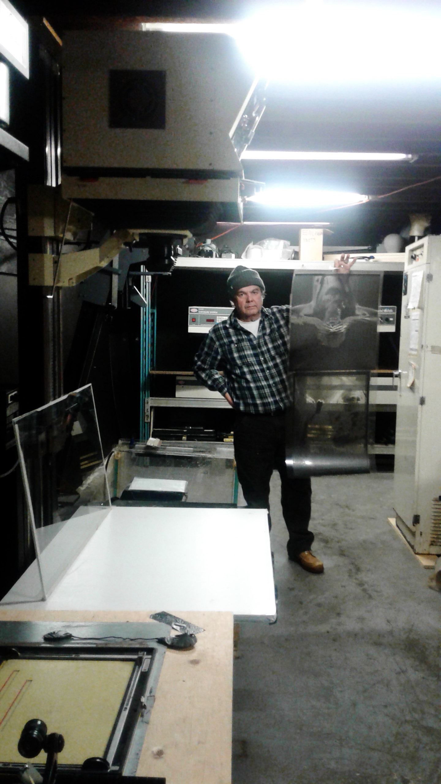

    I agree with nmp on this
    You can use a Lambda, you can use a LVT recorder , you can even have stochastic film made for this purpose... I agree the reality is to make a negative that actually looks like a negative.
    With inkjet negatives , the real complexity is forcing the ink to lay down in a predictable patter to make your life easier.. this is where a lot of mistakes are made, as a L value on your computer , dosen't necessarily match the corresponding value on your negative.... Thus one has to prep the printer and receiving material to record faithfully the L or K values... this is done by test , adjust and repeat... once all the values are correct you just need to make the file for the process..
    Once you figure out how to make the L or K values respond to any receiving film you are on your way and I believe any printer should work with the right person doing the testing.
    When I do this on Silver, the Lambda linearizes the film to 21 equal steps by adjusting the laser output... once this was done when I first tested this I then took the step wedge that was good and printed it on Pt Pd. once I figured out my chemical ratio/ exposure/development to make the best step wedge I could I then moved to the final step.. I took a sampling of images that I like and then did a curve variance of each image on one film like a contact sheet, then used my established pt pd workflow and made a print... It then became very obvious to me which curve shape worked best in my darkroom.... I saved that curve and apply it to my files whenever I want to do a silver negative for pt pd using my Lambda. Usually the simple S curve idea is good for this purpose where I raise the 3/4 tone and lower the 1/4 tone by about 5-10 units.
    so in short ,if it looks like a neg, acts like a neg... its probably a neg.
