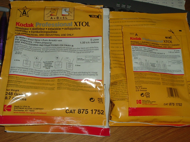

Hi guys and gals,
Can someone tell me why these two packages of Xtol have different quantities/proportions of A and B?
The first image is a picture of the "A" packets (248 grams vs. 73.7 grams), while pic #2 is of the "B" packets (268 vs. 444).
Any ideas?
TIA!
Steve

srs5694
May 18, 2005
2,718
Woonsocket,
This is just a guess, but: This Usenet posting presents what it claims to be the XTOL formula, based on Kodak patent information. Although I wouldn't bet money that it really is the production XTOL, it's probably in the right general ballpark. The Usenet formula has sodium sulfite in both the A and the B packets, and in fact that's the largest single component of (the Usenet version of) XTOL by mass (prior to mixing in water, anyhow), with a total of 10g in part A and 75g in part B per liter (50g and 375g, adjusted for the 5-liter packets you showed). Thus, my guess is that Kodak decided to shift some of the sodium sulfite from packet B into packet A or vice-versa, depending on when the two XTOL products were bought. I've no idea why they would do this, although I could speculate (improving reliability, improving mixing characteristics, reducing manufacturing costs, etc.). If I'm right, then the final mixed product would be identical in either case. (I note a 1.7g discrepancy in the total masses on the packages you've got, though. If this isn't just rounding error, it could signal some additional subtle change in the XTOL formula.) Such changes in manufactured products are hardly novel. There's been a lot of talk here on APUG recently about Rodinal and its history, for instance, which has included (poorly understood) changes in Rodinal composition over the years.
If you're concerned, you might consider calling Kodak and asking about it.
Wow, what a concept, pick up the phone!
I had my doubts that I'd get a living human being on the line, but I gave it a shot. Nice to know you can still talk to someone at a major corporation.
According to the very nice gent I spoke with at Kodak, Xtol was recently repackaged, to make it easier for the chemicals to go into solution. He claims that the resulting developer is exactly the same stuff as before.
One of my packages has an expiration date of 2008-08, while the other is marked 2008-06. Assuming a 3-year shelf life, I guess they may have made the change sometime between June and August of this year.
Whatever! :smile:
Thanks for your advice, guys.

Thanks APUGers. I mixed the second last batch of xTol I had on the shelf tonight and always check for the earliest "use by" date and noticed the considerable change in weights of Parts A and B of the more recent mixtures. Interesting I thought. I'm sure there'll be something on APUG about this. The fact that the last post was almost 18 months ago probably says something about the vitality of the B&W market in a relatively small economy like Australia. Either that or I'm just not shooting enough film lately.
hal9000
Sep 17, 2005
226
Berlin, Germ
Kodak changed the distribution of components between A and B some time ago. Here is some info from a recent package information sheet: "... Some components that were previously in part B have been moved to part A. Consequently, the part A ... might take slightly longer to dissolve than the part A packaged the old way. The part B should take slightly less time to dissolve. These changes allow the use of improved packaging materials that better protect the product during shipment and storage. The mixed developer solution should provide identical results to those obtained with product packaged in the earlier materials."
