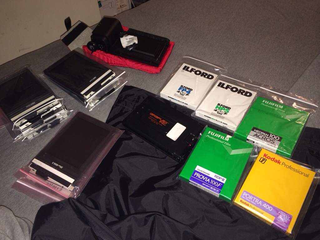

Haha guys I'm still using HP5+ Just for different purposes...
And trust me I'm letting my film in fact I'm loading it right now as we speak see... ImageUploadedByTapatalk1384122950.246464.jpg
