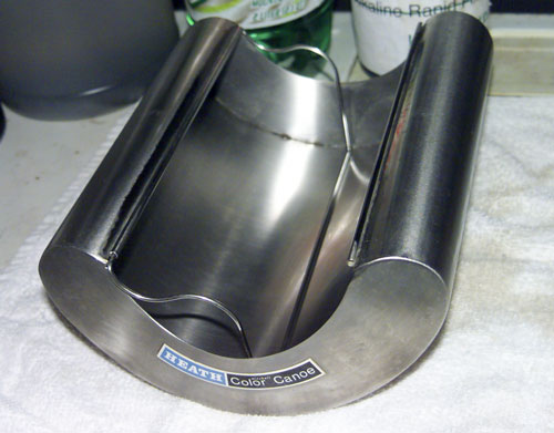

Another option would be to use what I do. I use the old Heath/Mitchell Color Canoe. It's basically sort of half way between a rotary tube, and an open tray. I have them in 8x10 size, and 11x14 size. Nikor also made a 'rocking tray' that's similar (I have one, but don't like it as much as the Color Canoe). Either of these uses small amounts of chemical (I use 8oz for 8x10 & 11x14).
The only drawback is when using one of these you're giving the print constant agitation (just like in a drum) which might give higher contrast.
