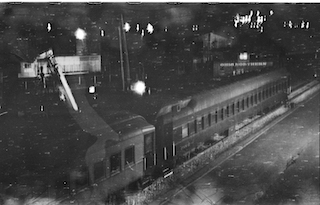

    I just developed my first roll of Ferrania's P30. Since they say it has a high silver content, very much like Adox's Silvermax, I decided to try and develop this first roll with that developer. It is a new chemistry for me and even still I know I am still very much an amateur, having only developed less than a dozen rolls in my life. Nonetheless, I am getting results poorer than expected and I am reasonably certain it has to do with my own skill as a learning developer. Can someone give me suggestions on what mistakes I made? There's some over developed spots, and some strange spotting throughout the film I'm not used to seeing in my other efforts.
    My setup: a Jobo hand developing tank
    Developer: Adox Silvermax 1:29 mix for 600 ml at 68 deg. F for 11 mins, agitating every minute for 10 secs.
    Stop bath: Kodak stopbath 1:90 mix for 1000ml at 68 deg F for 2 mins
    Ilford Rapidfix 1000 ml for 5 mins. img339 copy.jpg (I know this first image is blurred. Arm was bumped when I took the pic, but it shows the damage to the film much better than the clean one).

    Were these shot using flash?

    I don't think I'm seeing film issues. I'm seeing spots and dust. Dust comes mainly from where the film was dried, and from the scanning process. Spots come from drying, and during the processing steps if pouring is not smooth and rapid.

    Yes on the flash.
    For drying, I hung them up. Usually last rinse includes some Photoflo, so the water dries right off. Haven't had spots before. I'm hesitant about rubbing, even with a microfiber cloth, for fear of scratching emulsion. I have 3 cats, so I am conscious of the cat hair flying around, but these went to the scanner pretty quickly after drying.

    The last one looks like it could be a problem with a too high shutter speed with a flash. On the others, are the spots white-ish and opaque? That would likely be insufficient fixing (seems unlikely at 5 minutes), or spent fix. If that's the case, re-fixing in fresh fix might resolve it.

    It looks to me as though you have a light leak. I think it is in your camera as both top and bottom of your images show some issue. As noted above, the last image was shot using using too high a shutter speed as well as the light leak.

    I'm still an ametuer when it comes to using a flash. I didn't think it was a flash issue because it is such an even line. I thought that I did something wrong in developing it. The spots are white-ish. I thought they were residue from water. I VERY carefully rewashed and Photo-flo'ed them and rubbed carefully with soft microfiber cloth but they remained.
    After I read your post, I took a quick look and noticed my reusable fixer is no longer water clear like it had been. It has a very slight amber tint to it. I didn't notice it before. It may have been a result of fixing this film or it may have been there earlier and I had not noticed. Either way I will toss the rest.

    As there were dark night scenes I found it difficult examine the negatives properly. It doesn't look like your process was wrong although spots due to stray foreign bodies can be problem at any time with any film, developer or process.

    If the spots are white on processed and washed film and remained through the wash (as opposed to showing up after drying), the negatives are likely incompletely fixed, due to insufficient time, or spent fixer, or perhaps contamination. The spots in this case are unfixed emulsion.
    One way of monitoring your fixer use is to time how long it takes to clear the film, you can either do this with the roll you are processing, or use a piece of leader or other unprocessed scrap piece to check before you start processing.
    Either way, your total fix time for conventional grain films is twice the clearing time. Once the clearing time becomes twice what it was with fresh, unused fixer, that batch of fix is done and you need to mix fresh. T grain films like Kodak TMax or Ilford Delta need additional fixing time.

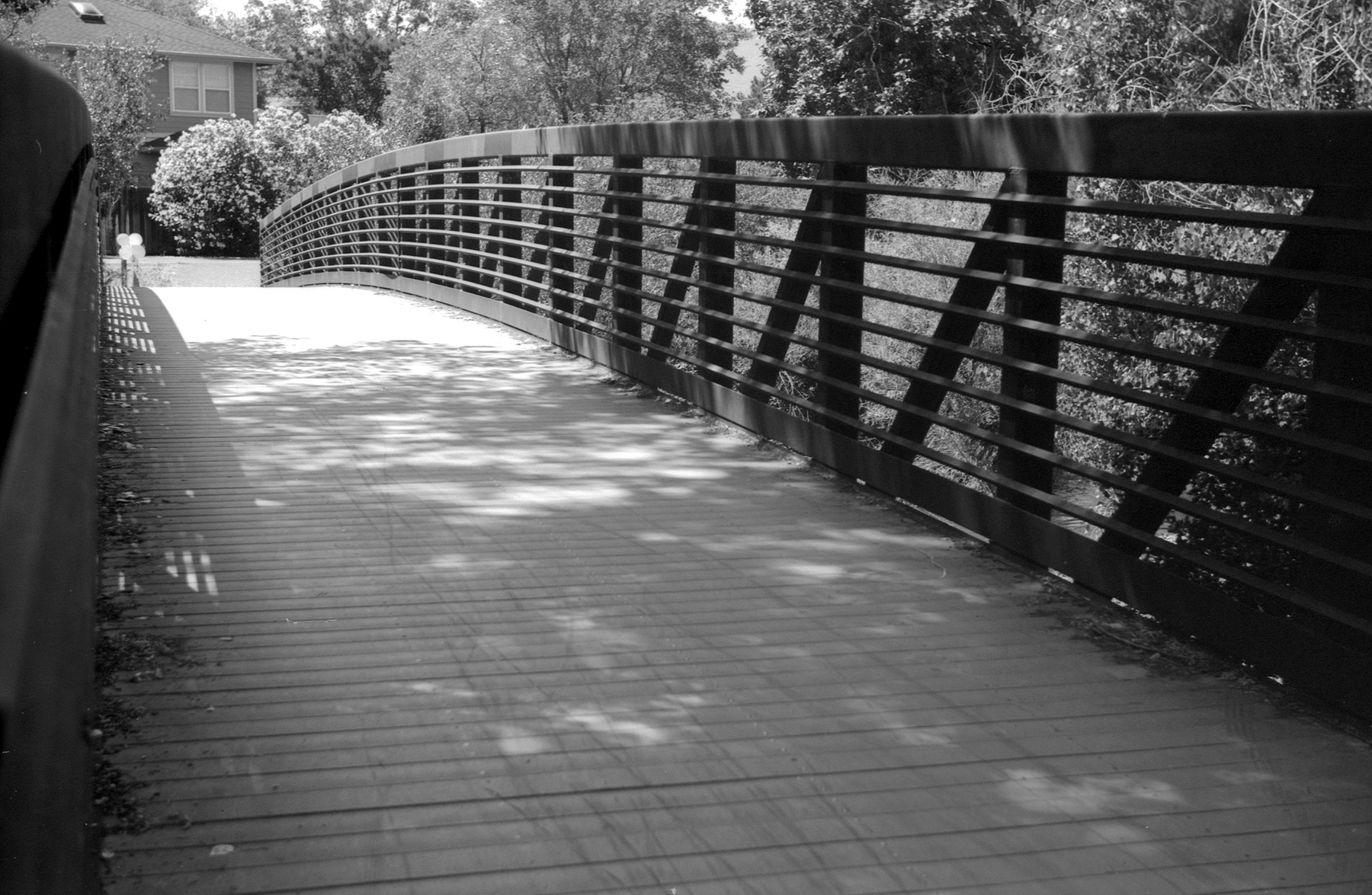

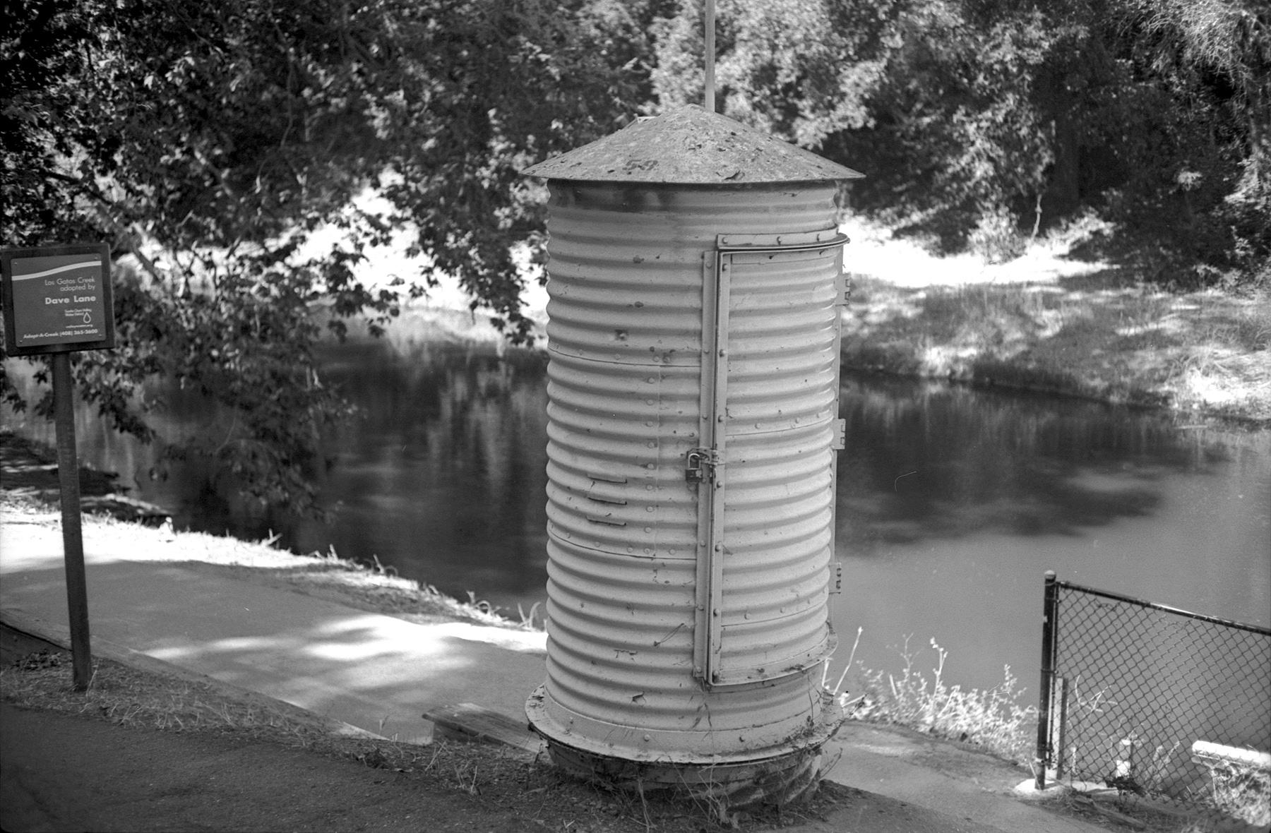

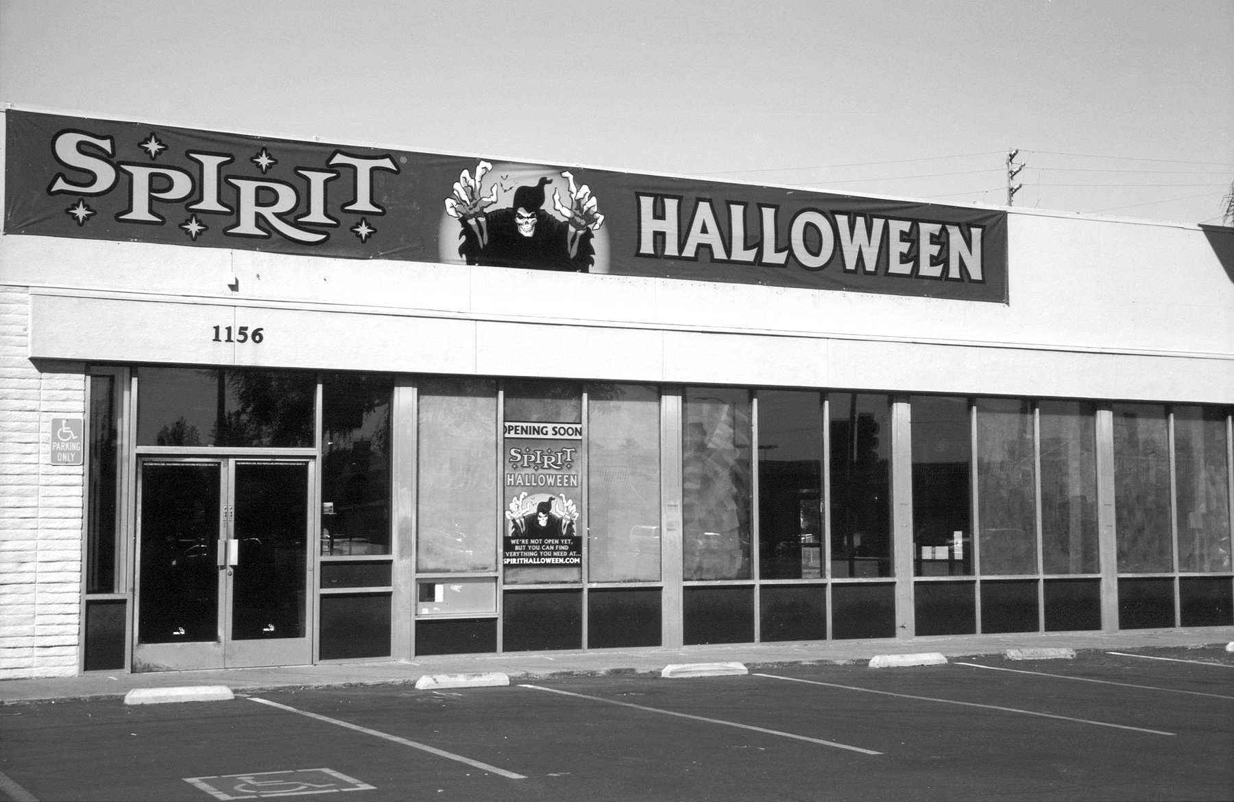

    Hello eharriett
    Did you review the "Best Practices" pdf on Ferrania website?
    You will have better luck using the developers they suggest to start, I used HC110 for the first roll shot at 25, 50, 80, and 100iso and some came out very nice and some under.
    So the second roll I shot at 40iso and developed with Pyrocat HD and I like it better.
    Here are a couple from the first two rolls
    one at 25 HC110
    one at 50 HC110
    one at 80HC110
