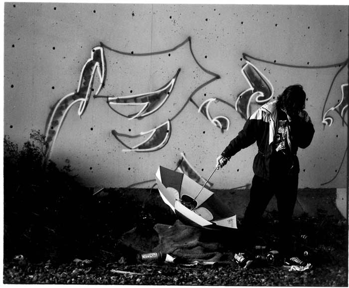

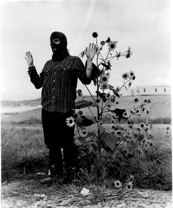

So recently I have been using WD2D+ in addition to my favorite, Rodinal. After the first couple of rolls I developed and printed from I really liked this stuff, great tones. But now I have become more critical and noticed that there is a streak in the same place in a bunch of negs/prints using the WD2D+, but not the Rodinal. So since it's not happening with the Rodinal I can assume that it's not the lens or back that has a leak. I use the recommended 2 min pre-wash and use the 1:1:50 dilution, and I get the streaks. Other than the developer, everything is constant (lenses, backs, film, etc.) Does anybody know what I am doing wrong here?
You will see the streak in the top center of the 'sunflower' picture... but it's no where to be seen in the other one. Both of these shots were with the same 120 back, 90mm lens, APX100... the sunflower one was in WD2D+ 1:1:50 for 9:30 (I think, it's the recommended time plus 30 sec.) and the umbrella one was in Rodinal 1:50 for 17:30. Any ideas? Thanks for any and all help. -Grant

It does look a little like the opposite of "bromide drag" to me. This looks like a streak of extra development, which would indicate the bromide is everywhere BUT the streak.
You say the streak was always in the pyro developed negs and in the same place? Such streaks usually depend on the subject matter, and should be in different places for different subjects. This is indeed a puzzle.

Gainer- after looking at my other prints with the streak I noticed that it isn't always in the same spot, but it is the same shape of streak. But it usually starts on an edge and moves to the middle. The streak in the sunflower photo was in the sky, and some of the others were over the subject matter.
