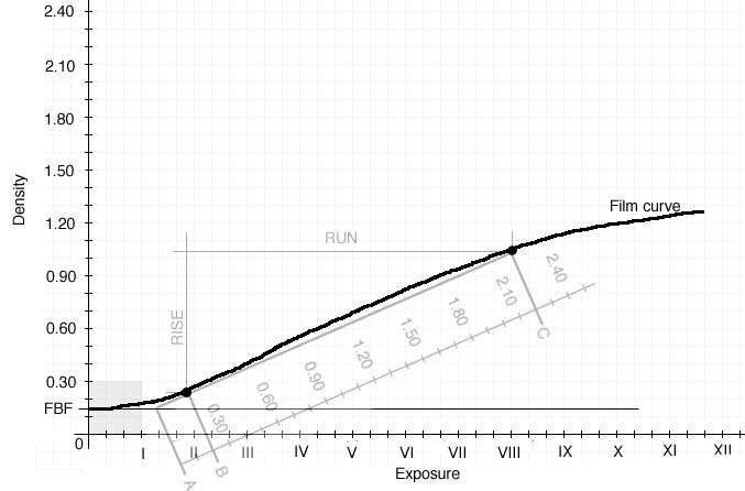

Get ye some standard graph paper and scale the vertical axis for density in 0.10 intervals. For the horizontal axis have a spacing interval of one stop (zone) equal to 0.30 density units. From the same graph paper make a ruler scaled identically as the vertical axis. Make an index mark at the edge of origin of the scale and mark it "A". Go to the 0.20 value and make another mark labelled "B" at the edge. At a value of 2.20 make a mark "C". (I'm relating this from memory but the last value is 2.20 IIRC. Check this in the Kodak or Ilford literature or perhaps someone else could confirm?)
Once you plot your characteristic curve of film test densities vs. exposure, determine the level of fbf and draw a horizontal line through the (0.00 net density) FBF value parallel to the horizontal axis. Take the CI index ruler you've made and position point A on that horizontal line. Slide the ruler along that horizontal line pivoting the ruler until points B & C both lay on the characteristic curve you've drawn. When you have A on the horizontal line and both B&C on the curve at the same time, the slope between points B&C will equal the Contrast Index. Make a mark on the curve where B&C intersect it and measure the rise over run to get the slope or CI. The rise is the vertical distance (difference in density) from point B to C and the run is the horizontal distance between the two points.
As an example, assume B plots on the curve at .30 gross density (at Zone II 1/6 exposure) and C plots at 1.40 gross density (at Zone VII 1/2), and that fbf is 0.15 density. The rise is then C-B or 1.40 - 0.30 = 1.10 density units. The curve will be such that the horizontal distance between B&C is about 1.15 density units (remember the horizontal scale is based on the 0.30 unit interval on the vertical axis). The Contrast Index for this curve would therefore be 1.10/1.15 = .97 approximately.
If instead the numbers were B = 0.25 density (at Zone I 5/6) and C = 1.05 (at Zone VIII) with fbf = 0.15 this curve would have a CI of (0.1.05-0.25)/6 1/6 exposure zones = (0.1.05-0.25)/1.85 = .43 as shown in the example picture which will hopefully post below.
It's pretty easy to actually draw this on graph paper and determine CI. It's probably much harder to explain or read.
Joe

I'm back at work, it is Monday (hooray ???) and I'm able to check these numbers. In the 1987 version of Kodak Professional Black-and-White Films (publication F-5) on page 19 there is a description on how to determine CI. The figures for the CI ruler I quoted last week are in fact correct.
Now, I'm trying to see where the conversation got sidetracked into one of BTZS rather than CI. As I do, I'm looking at Davis' 1981 version of BTZS and trying to see how CI fits into his system. It would appear to me that Davis is actually defining density range and subject brightness range on the basis of Ilford's G-bar rather than Kodak's CI, and that these two determinants might yield different values for DR and SBR. For example, the graphs on page 35 (under the "Curve Gradient Measurements" heading) would appear to indicate greater SBR and DR when using CI vs G-bar assuming those graphs are scaled the same. Is this correct?
If so, couldn't I just take all my CI curves and convert them to the simpler G-bar measurement and then determine SBR and DR ala Davis? Then, I'd at least be on the same page as the rest of you perhaps.
Conversely, I'm wondering if the Kodak system might actually represent the standard way of expressing SBR and DR? Or, has the Ilford/Davis method become the standard amongst photographers? I'm wondering because last year if y'all recall, I was at my wits end trying to determine what various authors meant by the term "density range" in relation to their film exposures needed for alternative process printing in various media.
Joe
From what I've read on the subject, the two systems (Kodak and Ilford) are not in complete agreement. Kodak claims that negatives developed to the same CI will print on the same grade of paper, not that they will look the same when so printed. The reference points on the Kodak system are closer together. The high density point is lower in the Kodak system.
