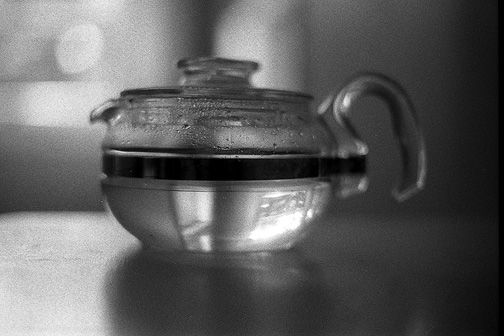

Hello,
I just shot my first roll of Delta 3200. I did a lot of research on it and decided to rate it at 1600. When I brought the film to the lab, the lab tech asked about the rating. I told her 1600. She suggested that the film be developed as if it was 1600.
I would love to hear your recommendations for developing, should the film be developed at 1600 or 3200?
When I looked at my contact sheet, I was a bit dissapointed in the frames. I scanned the film in on my 4990 and the negs look like they have a lot more information on them then the contacts. Here is a scan from the roll. I made adjustments in contrast and sharpened up a bit for the web.
Unfortuanately, I had to shoot 35mm film, it's all my lab had. I just picked up a couple of 120 rolls and am anxious to shoot this film again.

The reccomendation from many people is to develop as u underexposed it more, eg shot at 1600 dev for 3200 ect

Dear Nancy,
I've been shooting this since before it came out (Ilford gave me some advance rolls) and I generally expose at one stop slower than the nominal dev time for that EI. In other words, yes, exposing at 1600 and developing for 3200 (or exposing at 3200 and developing for 6400) makes sense.

I agree with Rodger, expose at 1600 and develop at the 3200 development time, if you highlights seem blocked you can then reduce the time.

My initial intent was to develop for 3200, but the tech said I should develop for 1600. What is the benefit of developing at 3200?
My personal experiance has been that both TMax and Delta 3200 do not give very good shadow detail at the box speed, by rating the film at 1600 you are really exposing for the shadows. If you develop at the 1600 time you are under developing to some degree and will have flat or thin negatives, if you develop at the 3200 time you have good shadows but may have blocked highlights, in which case you can ask you lab to reduce the development time by 10 to 30% until you find the best development time for both shadow details and highlights. this is one reason that many folks develop their own film so they can make adjustments for personal perferances. Sorry for the poor spelling I have not found the spell check yet.

Ok..thanks that makes sence. As soon as thing settle down a bit for me, I will be learning how to develop my own negs. When I metered for the photos I too, I metered for shadows, so the negs look good even at 1600. I'll definetly do a bit of testing to figure out the best way to develop.

Dear Nancy,
Time for a small dissent. I would have done just as the tech suggested. 1600 is only about a one stop push (I think that the Delta ISO rating would actually be in the 800 to 1000 range) and I find that the moden (Delta/T-grain/sigma) films collect a lot of detail in a thinner negative. Once you match your printing contrast to the negative contrast you will find the extra information that you see in the scan.
