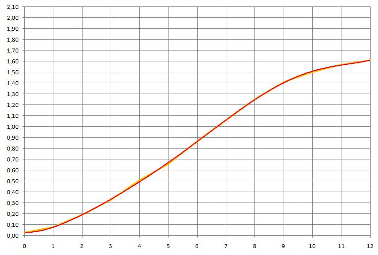

What old-style film has a big shoulder?
Perhaps big shoulder was wrong term?
I tried to describe the typical shoulder of S-shaped curve.
Some traditional films has very similar linear curve like tmax. Fp4+ is one of them (at least when developed by me).
Most have more or less shoulder.
The Adox/Rollei Pan 25 curve is in attachment, I call this a big shoulder - but is it?
A normal brightness range has about 7 stops. All films I'm familiar with show no curve to speak of up to a range of 10 stops (N-3), including your graph. Consequently, there is no significant difference between TMax and 'traditional' films as far as a shoulder is concerned. You have to 'starve' your developer to get the highlights to roll off into a shoulder, and I recommend against it, because the straight line of the characteristics curve produces much better highlight contrast.
