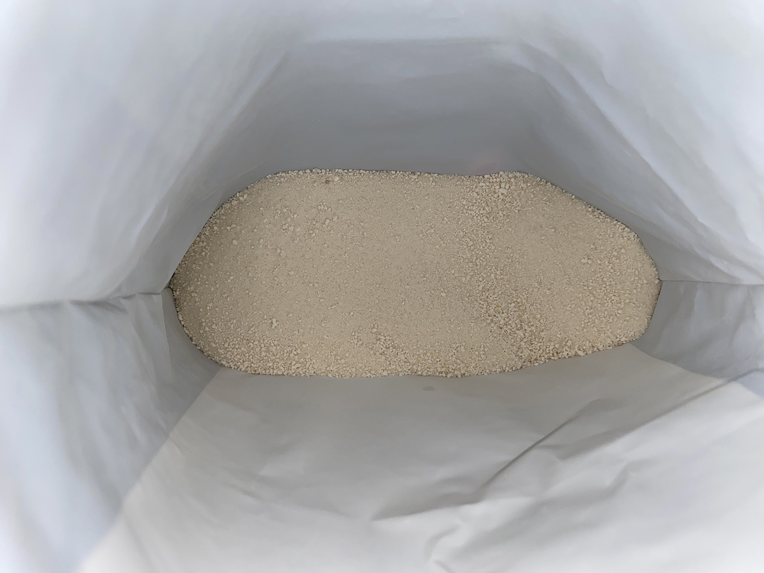

D76 is not supposed to be this yellow/beige, right (and this was taken with flash, so it's even cooler than IRL)? The first batch I got was dark brown, this one is still not white but not quite as bad. But in the past the powder has always been pretty pure white, and from the videos I've watched on YouTube the powder looks almost as brilliant white as the envelope.

There is a batch that is dis-coloured. And volumes are such that there may not be a lot of different batches out there at any one time.
From Kodak Alaris' Kodak Professional Facebook page:
Quoted here:
Kodak Professional
4 hrs ·
"Let’s talk D-76.
If you have Catalog #1058270 (Batch 2020/01/23 8438 & Batch 2019/10/09 8432), you may have noticed a discoloring of your product. Please know we’re aware of this and apologize for the inconvenience or confusion this may have caused for a product you’re well used to.
Rest assured we want to get this taken care of for you. Please email us at ProPaperChem@KodakAlaris.com and our team will be back in touch to provide you with next steps on this specific product.
*If you have the product in your care and have not yet opened it, we encourage you to reach out to us for next steps as well.
For any questions in the meantime, please don’t hesitate to be in touch with us via email or private message!"
