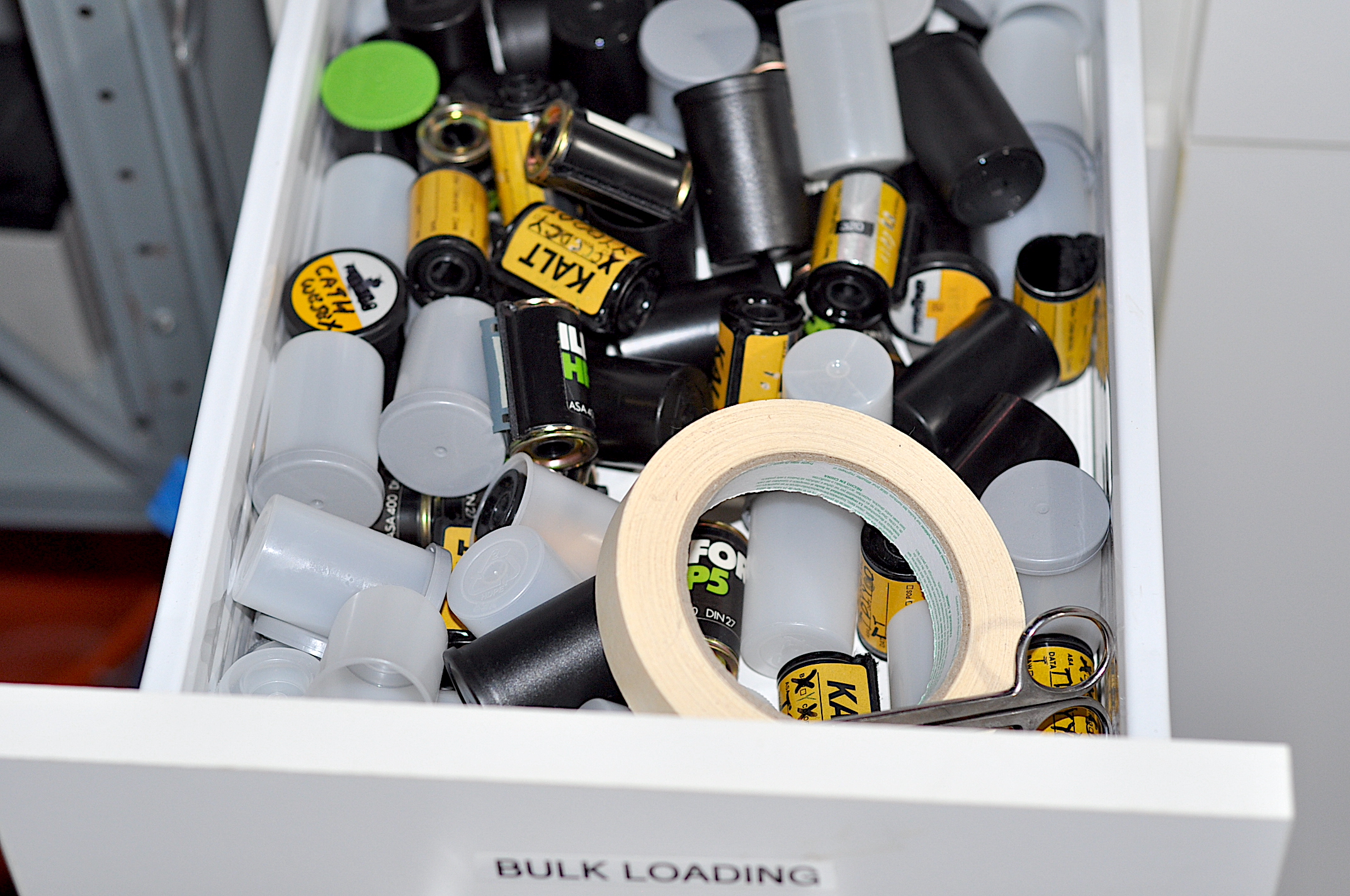

For now I am just re-using my spent 35mm cassettes by taping the film to the remaining bit of film left.
It doesn't feed our need to buy new photographic stuff, but works just as well.
I have FILCA, IXMOO, Nikon F and Nikon AM-1 casettes as well as unbranded metal casettes in current use, and they are not better or worse than reusing commercial casettes like you do.
My experience doing the same with my own and the local mini-lab customers' ones has been excellent. They can often be freer-running than the plastic re-usable ones and in the case of the mini lab's each cassette has only has one film through it so the felt light trap tends to be in excellent condition. The only slight issue is that the mini lab's machine leaves only a small piece of the remaining film out of the cassette but there is enough to be taped if reasonable care is exercised
pentaxuser
Jul 31, 2012
3,387
Just make friends with someone at a minilab and you will have all the cassettes you will ever need. I've never run across anyone that said no if I asked for their used cassettes. I haven't looked for them for a long time though since I probably have hundreds now. I imagine these days there might be a demand for them.
Taping film to a used cassette is the easiest way I think. Otherwise you are fiddling with caps. A while back I picked up some old Kodak and Agfa snap cassettes for nostalgia and the first thing I did was tape in a leader so I never had to open the cassettes again.

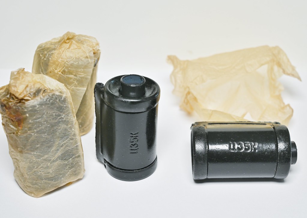

Assuming we talk about the same "U35K" cartridges as depicted below, I'd have to say they are crudely made, very typical of the Sovjet Union era. I do not have problems dropping them into - and removing them from my M's and LTM's but I admittedly mostly use IXMOOs and FILCAs in those cameras.
I wouldn't be surprised if there was bit of sample variation causing some cartridges to give resistance when removing from the camera.
Charming product never-the-less, and if they work they probably will forever.
This is how they were packed from the factory - still smelly and sticky :smile:

btw. I thought the uneven exterior of the cassettes was hardened rust protective oil - and it may be - but if trying to wipe it off with alcohol, it will take the paint as well, so don't do that.

Yes, those are the same ones I have and, yes, they are of a "quality" one would expect from that part of the world. I've only recently started using them so time will tell the tale.
yes, those are them.
I actually got two orders. One from an etsy seller wrapped in paper like that. Mine weren't sticky though. The second order was from an Ebay seller. They were all clean, no paper, no sticky, and perfect and packed in a box nicely. Alas, they took 7 weeks to get here, but that's international bargain rate shipping this winter, not the seller's fault.
And variation is almost guaranteed. There's nothing precise about the manufacture. Stamped steel and rolled steel and there's no doubt in my mind nobody was maintaining the dies on their machines until the machine failed.
