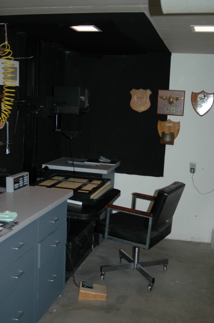

Early on, I experienced significant fogging issues. These were caused by a Thomas safelight and enlarger light leaks. To resolve these, I replaced the Thomas and painted the walls and ceiling adjacent the enlarger a flat black. I also used copious amounts of black gaffer's tape to eliminate the light leaks in my Saunders VCCE enlarger.
Fogging is an insidious problem that many are fighting without even knowing it. After you have done everything you can to prevent problems, do a fogging test with your safelight and enlarger (cap over the lens) on. You will save yourself frustration and paper! :smile: Follow the Kodak safelight test procedure. The coin-on-the-paper test or its variants is worthless! The Kodak test is available at this link:
