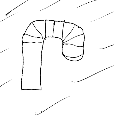

    How about swiveling the existing ell to point upward and putting two more ells in to create an inverted U against the wall? All would painted flat black inside, ideally. You might want some sort of bracket or brace, or maybe just a fastener through the bottom edge to avoid it getting too wobbly.
    (Excuse the 1906 CAD ...)
    Dave T

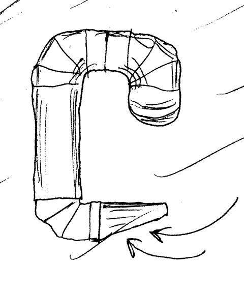

    More thoughts.
    You could add one more ell on the bottom of the tube, ideally with the opening pointed north, or located such that it never gets direct sun.
    In addition, a diagonally cut section of pipe could be added to shade the opening.
    Obviously the more bends added, the more impedance to air flow, but I think this would be a reasonable compromise.
    DaveT

  16. Robert Hall
    Robert Hall Member
    Messages:
    2,038
    Joined:
    Aug 18, 2004
    Location:
    Lehi, Utah
    Shooter:
    8x10 Format
    They're right, you need at least one more bend.

    Another bend would cost a lot, can't I get away with it with three sheet baffles like I demonstrated?
  18. DWThomas
    DWThomas Subscriber
    Messages:
    3,278
    Joined:
    Jun 13, 2006
    Location:
    SE Pennsylvania
    Shooter:
    Maybe -- I'm certainly no authority on this stuff. I was thinking the bend might be a standard plumbing item something like what is called "stovepipe" over here. I would think you could cut some cardboard baffles and tape them in the way you show in your drawing. That would likely not be a permanent solution, but it would provide a way to try the idea. Looking at your picture, it occurs to me you could surround the bottom of the pipe with a box or upside down trash can or similar enclosure. Have a hole cut in the bottom (now facing up) to snuggly fit the pipe and seal the joint with tape and some sort of black goop. Cut part of one side out of the box or can, maybe even put in a screen or louvered baffle. Then orient the opening toward that wall to avoid direct sunlight entering, leaving enough clearance from the wall to get good air flow.
    Just writing/thinking out loud here. I'm not a ventilation or darkroom construction wizard but those are ideas I would probably try.
    DaveT
