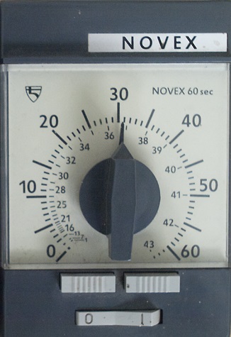

It's probably a bit late in the day to join Craig in putting in another good word for the very dependable Novex R timer, but perhaps my two bits' worth can benefit newer members who are wondering where to find an affordable darkroom timer.
Czech precision mechanics are outstandingly reliable and durable ('Planned Obsolescence' definitely played no role in post-war Czech industrial production). I have two working Novex timers, one at home and one at the youth club. They are about 45 years old, and both are still eminently trustworthy. I think a beginner could do much worse than pick up a Novex R; they are plentiful at European auction sites and can be had for a song.
Regards, Michael
PS: The only thing about them I havent figured out is what to make of the inner scale on the display (see picture). The ascending arithmetical seconds scale is self-explanatory, but the descending logarithmic scale remains a mystery to me - but then again, I have never needed it. Suggestions would be most welcome, however!
