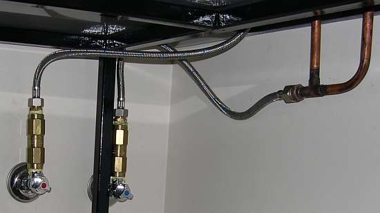

PeterB
Apr 3, 2005
644
Sydney, Aust
When my plumber connected my hot and cold faucets of the darkroom sink up to the main lines in the house, he used double non-return valves (I've forgotten their exact name - if someone needs to know I can look it up).
This kind of protection is mandatory on sinks in chemical labs because hoses could be attached to the taps and may then rest on the bottom of the sink; there is always a chance that chemicals in the sink are siphoned back into the main line of your building should the water be turned off in the building or the building's street.
He also wanted to use an automatic shutoff valve in case something burst when we weren't home, especially since the floor has no waste drain hole. I opted not to put one in, since at the time my budget was a bit tight.
