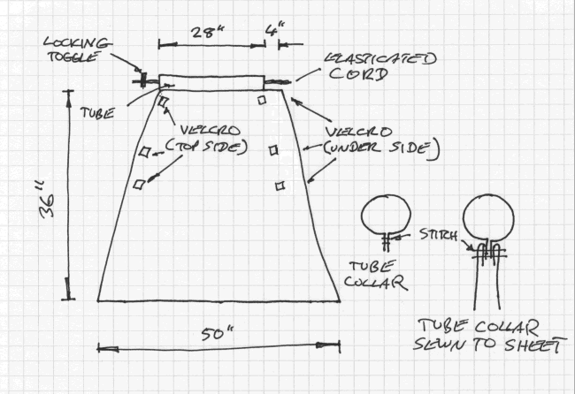

Here's mine for a 4x5 - I expect it will scale up for an 8x10 etc... It has evolved from a horse-blanket in a piecemeal manner over the last two years. Being wider at one end allows the material to drape over the head and shoulders and being thinner at the camera end makes for less material flapping about in the wind.
Material is a lightweight waterproof fabric from an outdoor materials supply company (in this case, http://www.pennineoutdoor.co.uk/). It is breathable (which does not actually work in this situation - ho hum) and black with a soft ("plush"?) finish on one side. Unfortunately, I can't remember what it is called... The material is doubled to make it fully light-tight (I suspect this is why the "breath-ability" doesn't work).
The business end uses an elasticated cord with a locking toggle as used on outdoor clothing. There were two thicknesses available, I used the thinnest. The cord makes sure of a tight fit over the back of the camera and the toggle allows you to adjust the overall length of the cord to adjust the tension and to suit different camera backs.
Materials: Two pieces of suitable material of the size shown (add extra for seams). A bit more for the tube collar. Elasticated cord. Locking toggle. Sew-able Velcro (or large plastic press-studs).
Instructions: The main sheet is made from the two pieces of material sewn face to face along the edges except for the short end seam. It is then pulled inside out through the short end so the soft face of the material is on the outside.
The tube collar through which the elasticated cord is threaded is made from a 4" wide strip that is about 4 inches shorter than the short end of the main sheet. This gives an overlap when used on the camera that helps keep the dark in. Sew this in to a tube as shown in cross-section and finish each end to stop it unravelling. Once sewn up, the tube is sewn to the short end as shown, closing that end of the sheet (turn in the edges of the main sheet as shown to get a neat(ish) finish...).
The shock cord is threaded through the tube collar (you will find you need a lot less cord when you attach it to the camera, but start with 30-34" to keep life simple). Thread both ends through the locking toggle. The business end is now tube shaped.
Sew-on Velcro is used to hold the two edges together with a gap for the hand to reach in with the loupe. Place the tabs on the Inside of the cloth on the overlap part at the same depth in from the edge as the depth of the overlap. The other Velcro tabs go on the Outside of the cloth along the opposite edge. In conjunction with the cord, the Velcro creates the "tube" of the darkcloth.
Exact placement for the Velcro is best done by putting the nearly finished cloth on the camera and finding the best locations for your setup by trial and error. You could try replacing the Velcro with large plastic press studs which should last longer and won't pick up fluff and lint. For a sinister version, put the Velcro tabs on the other sides...
That's about it (blimey! This post grew like Topsy!). Any experienced sewers please feel free to correct my methods to get a better finish - especially at the collar end :wink:
Cheers, Bob.

First, I can't thank you all enough for the detailed and very informative descriptions on where and how to obtain and make a darkcloth ( I love all the drawings!!!). This all has been quite enlightening!
It might have helped had I stated in my original post, that I am in south Louisiana...during our summer months (which are usually 10 months out of the year :wink: ) it can get quite humid along with the sun's heat. So yes...the dark cloth being lighter in color on the outside would definitely be an asset to me.
As for my subject matter...while it can vary, I make photographs of people more than landscapes, architecture, etc. I'm thinking I'll attempt to make my own darkcloth (I sew plus I'm quite industrious...love hand-work). I would probably make it on the larger side to have easier enter/exit access.
