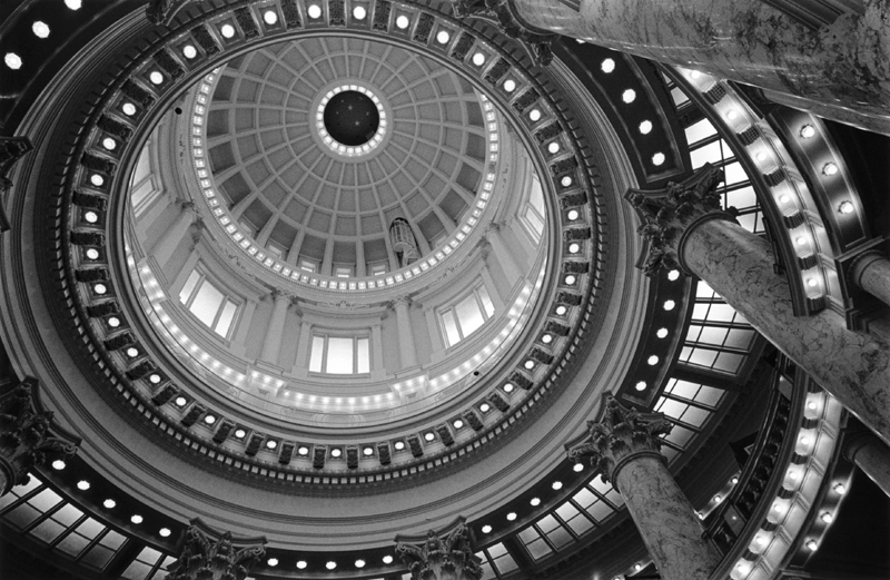

D76 works great with TMax films. Use it with everything from 35mm to 8x10. I also like HC-110 for convenience, but if I have a lot of film to develop, I'll mix up a batch of D76. I prefer to use it at 1:1 and generally rate my film at 1 stop overexposure. For wet-printing, I prefer the look I get from a denser negative. Hard to go wrong with it.
TMax 100 (35mm), D76 1:1, printed on Ilford MG
That is a beautiful photograph.
