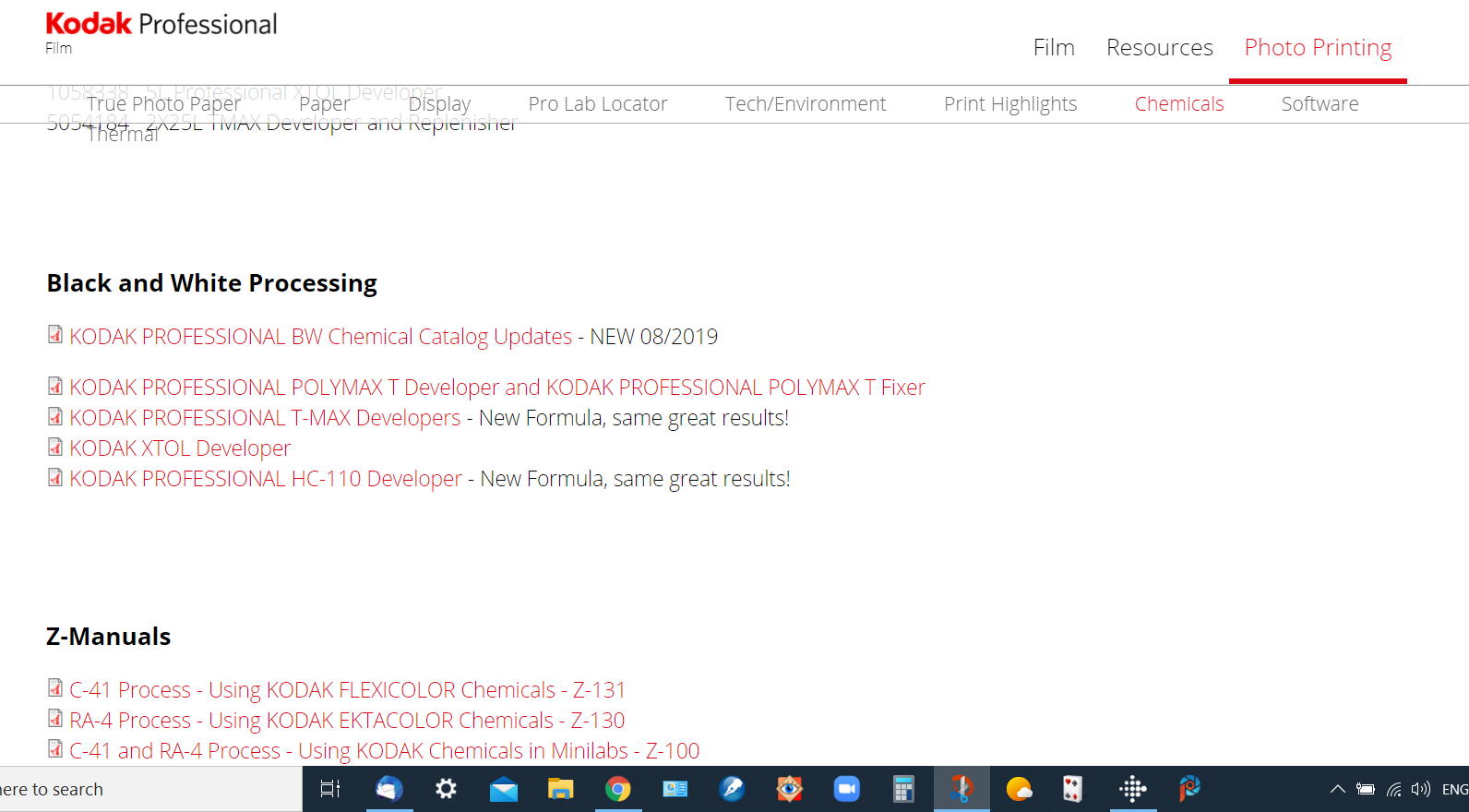

Just a warning, Kodak Alaris advised me that that version is out of date, and has been pulled from the website until it can be updated. That link may be a cached version, or maybe it still shows on some of the regional versions of their website. When I access the Kodak Alaris chemical page on their website, it shows this way:
The link to that page is this: https://imaging.kodakalaris.com/photographers-photo-printing/resources/chem-tech-info
With the way the Kodak Alaris site is structured, it is possible that people in different parts of the world will have that link re-direct to different pages.
I don't know how long it will be before the information pages for the chemicals and colour paper and lab related products will be moved to sites maintained by and identified as Sino Promise Group.

Its funny that they removed the link to the D-76 PDF, because the links to the tech sheets for HC-110 and Tmax Developer still go to the 2017 versions of those publications despite the "New Formula" announcement on the page where the links are.

The New Formula T-Max and HC-110 supposedly perform equivalently, using the same times.
I expect the biggest reason that the D-076 pdf is out of date is its references to the no longer produced replenisher.
