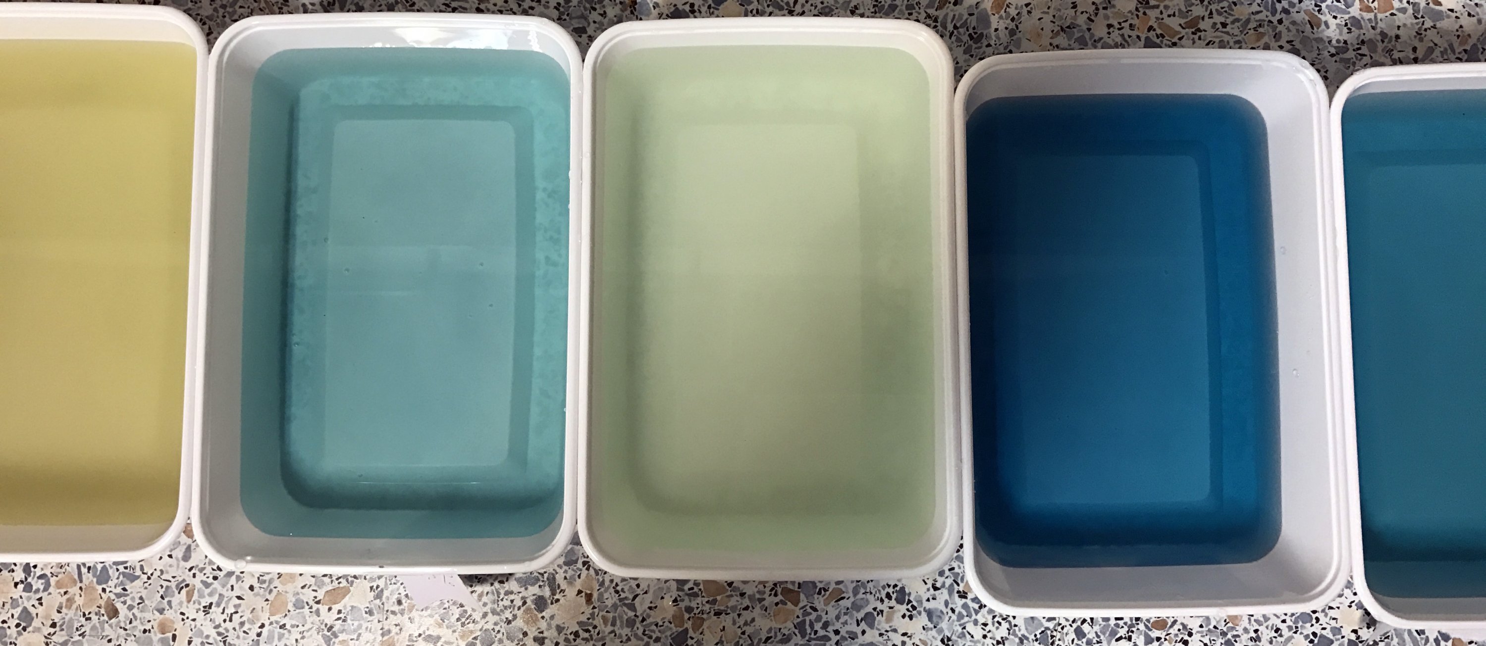

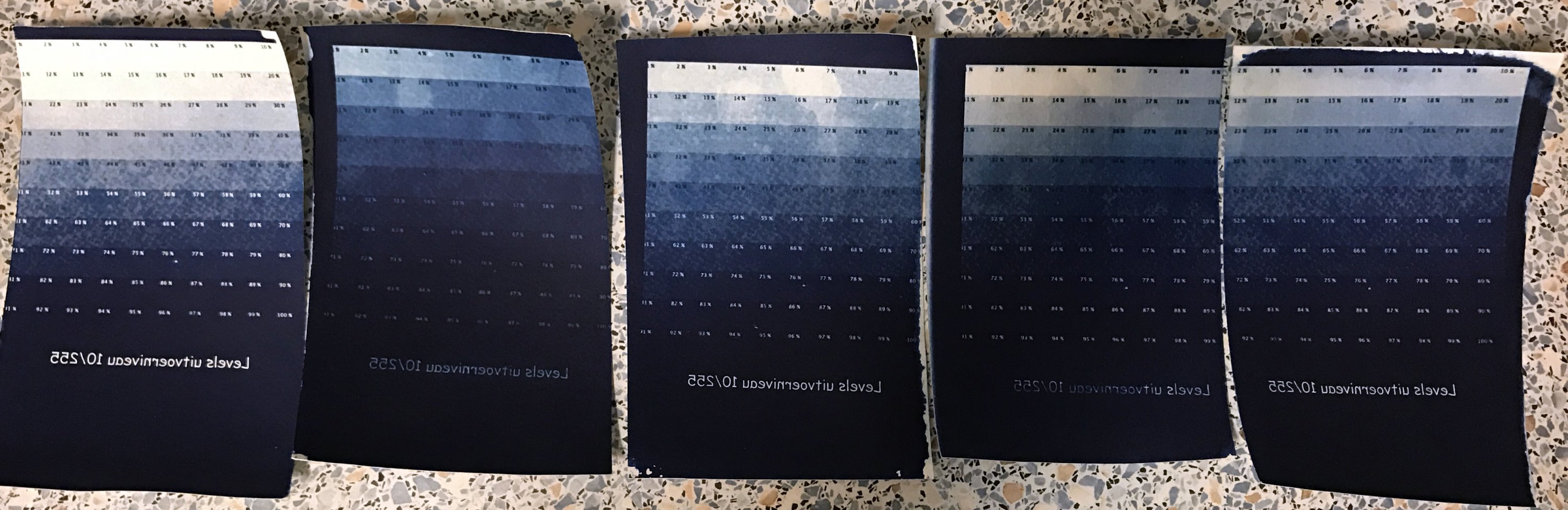

I’am still looking for the best workflow for my cyanotypes.
I chosen New Cyanotype formula.
Papers are still difficult to choose. But I Like ‘Terschelling’ it’s perfect available at local shop for reasonable price here in The Netherlands. I tried to buy Herschel from ruscombepaper. But the webshop does not work, they don’t answer my e-mail and this paper cost 3x the price of Terschelling.
Today I did experiment what’s the best ‘developer’.
All same time from my TL UV source 125 seconds
Used an test negative I made with an photocopier on overhead sheet.
I tried (this is what I had at home):
In the Photo attachment seen from left to right !
Tap water measured PH 8
Nitric acid 0,5 % measured PH 1.7
Oxalic acid 0,1 Mol /L measured PH 1.9
Citric acid 0,1 Mol /L measured PH 2.5
Acetic acid 0,1 Mol /L measured PH 3.4
Tap water is not OK very slight bleaching effect of only lightly exposed regions, resulting in a higher contrast and apparent slower speed
Acetic acid, Citric acid, Oxalic acid are near the same
Nitric acid is much darker. Why ???
Mike ware advice is the use of nitric acid. But the disadvantage is that it is not available for a private here in The Netherlands. And the other acids I can easy buy at the supermarket or drug store.
I’am still not sure what the best acid I can use. Acetic acid is cheap and buy 5L for €1,50.
Image runoff is different by each acid. See Photo from the developer trays .
