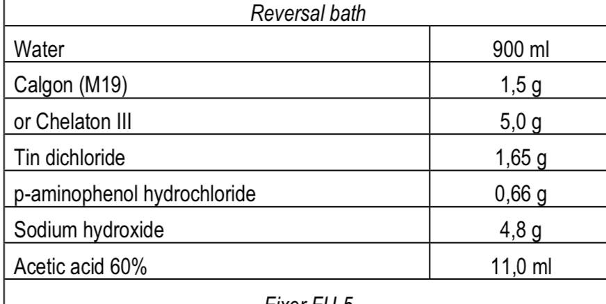

Hello. My recipe calls for p aminophenol hydrochloride, but i have plain p aminophenol. Should i use less of it, or use less alkali to maintain Ph?

I would like to mix Fomapan R reversal bath, but i only have p aminophenol.
Thanks for help.
You can substitute every gram of p-aminophenol hydrochloride with 0.75g of p-aminophenol base and 0.25g of Hydrochloric acid. If you don't want to use Hydrochloric acid, you can reduce the alkali used in your formula. If your formula has Sodium hydroxide, then you can use 0.27g less Sodium hydroxide for each gram of p-aminophenol hydrochloride. So if your formula is using, say, 10g of p-aminophenol hydrochloride and 5g of Sodium hydroxide, then use 10 * 0.75 = 7.5g of p-aminophenol base and 5 - 0.27*10 = 2.3g of Sodium hydroxide.
