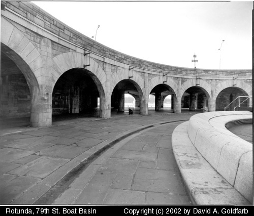

This image, for instance, was made on an 8x10" camera with a pre-war 120mm/f:14 Berthiot Perigraphe at f:44:
http://www.echonyc.com/~goldfarb/photo/79bb.jpg
This lens just covers (illuminates) 8x10". If you look at a print or the negative with a loupe, you'll notice visible coma in the corners, but it's not such a distraction really. I can work with it.
On the other hand, I was looking at some 5x7" negs that a friend made with a 90mm Angulon, and the sudden loss of sharpness at the edges was just unacceptable. It was as if the photograph had been made through a Coke bottle that was drilled out in the center.
