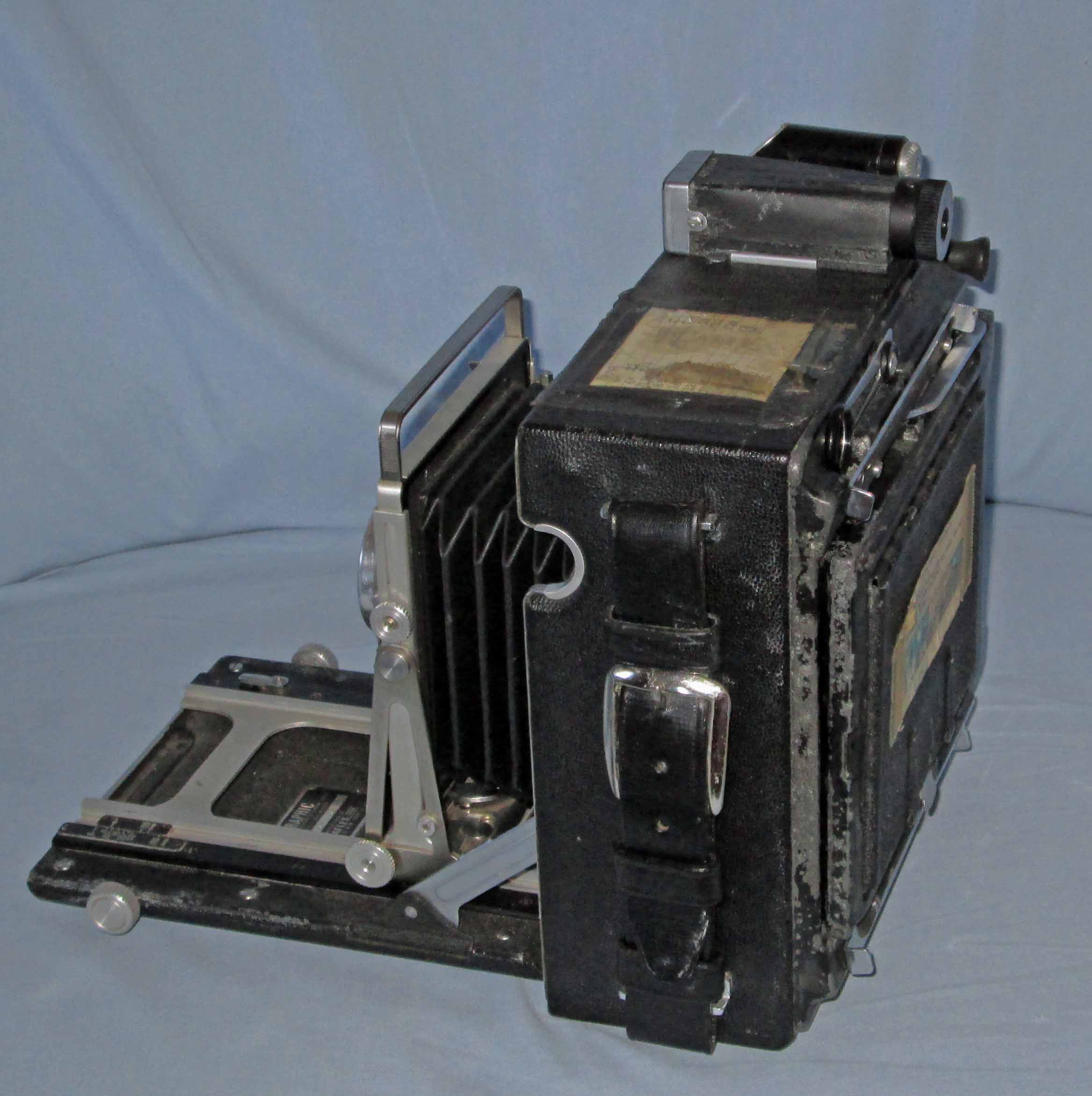

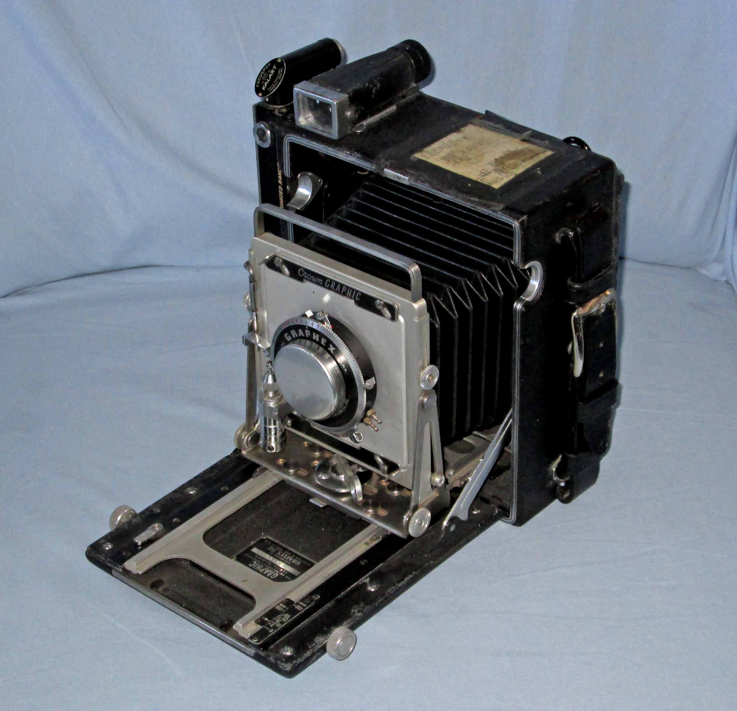

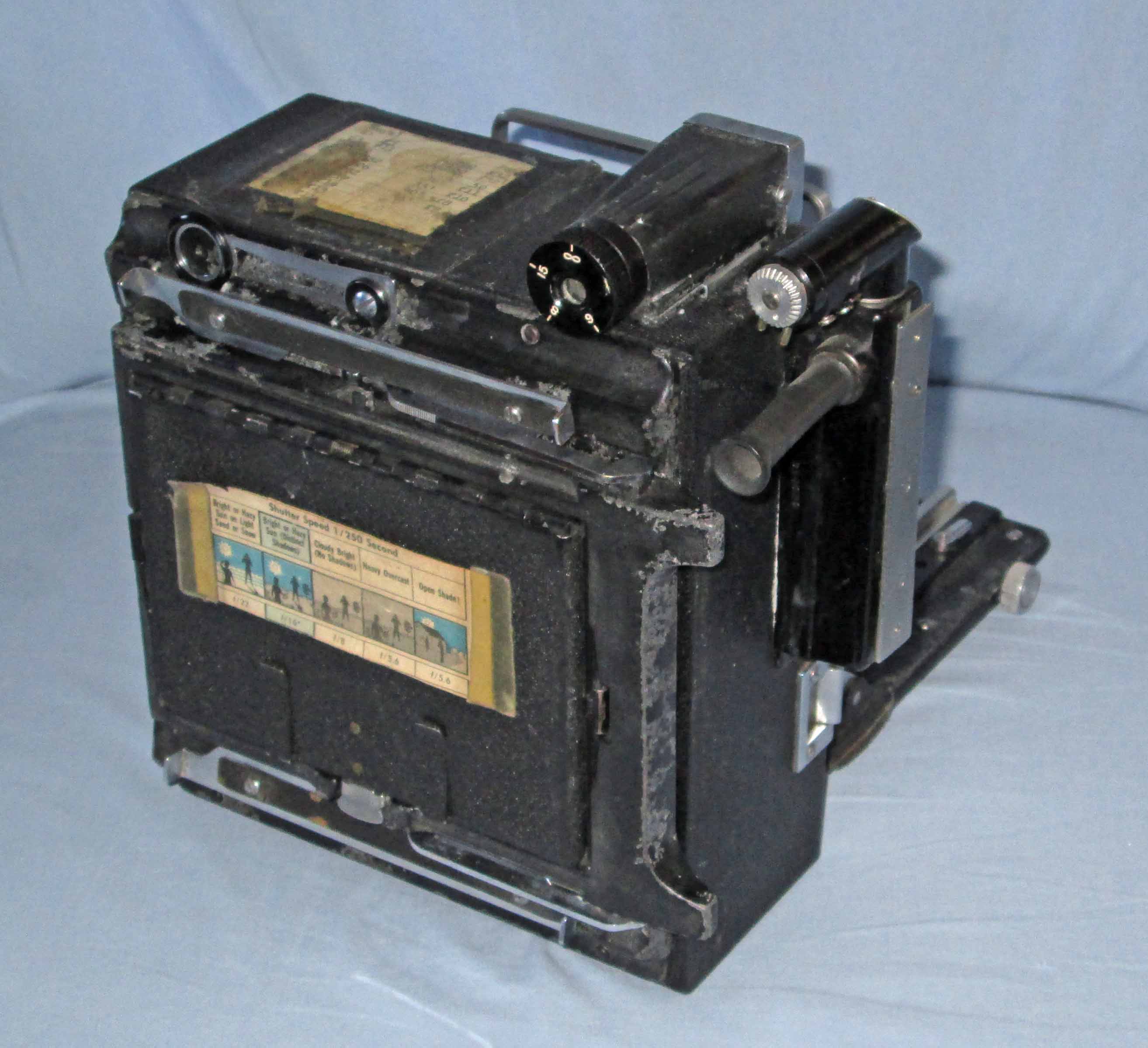

  22. OP
    blindpig
    blindpig Member
    Messages:
    117
    Joined:
    Dec 5, 2013
    Location:
    Nixa,Mo.
    Shooter:
    Christopher,
    Here's a couple of pics.You'll see that it kinda' looks like it's been around the block some.
