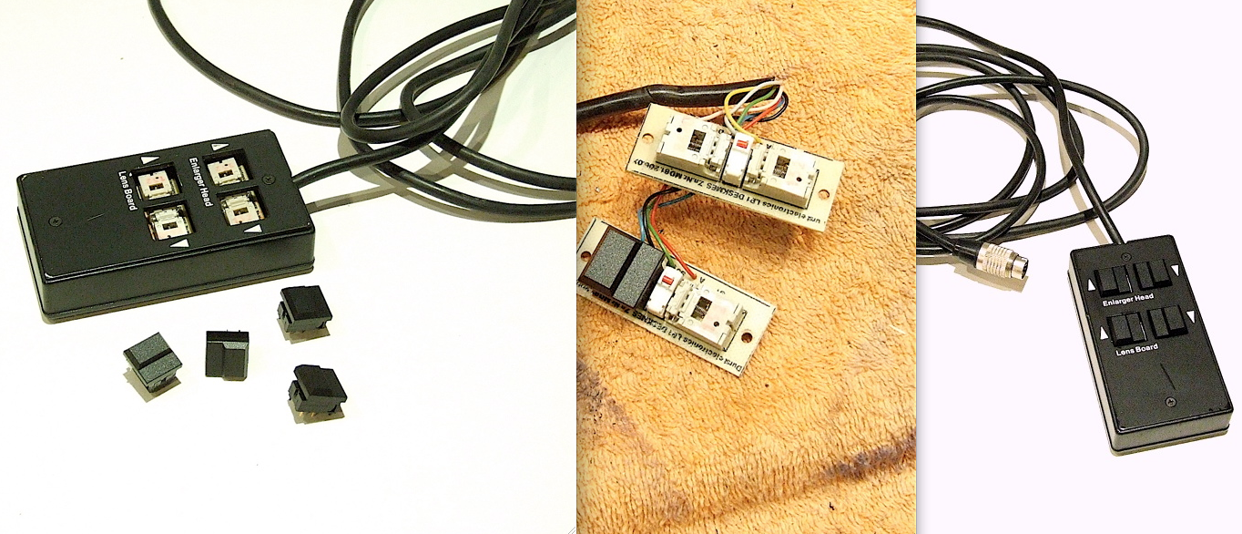

    I found this artifact on the web its a copy of the 1991 Brochure on Beseler's new Universal head I have one of these it's pretty cool. I'm looking for a virgin 8573 VC controller. The 8573 I have sometimes has sticky buttons that make it difficult to adjust timer. I have the color controller too, it works great, any way here's a link.

    As for your sticky button, you can try getting some electrical contact cleaner, squirt it into the switch and then working the switch vigorously...likely you simply have some dust on the contacts or oxidation of the contacts.

    Thanks for the info. I was reluctant to spray anything into the keyboard. Looks like the contact cleaner you mentioned wouldn't do any harm. I've had the color controller which I got with the head used, it works like new. Picked up the VC controller recently, I will try the cleaner, go slow, see how it goes.
    This head looks like the best thing Beseler came up with. Now if I can just get the buttons cleaned and degunked maybe all will be good

    Might have to take the thing apart and sand the button cover a little. I have four of these controllers, but exactly one button that annoys me in this manner. Whenever it gets stuck, once it stops, I just back the cc value back down to where I want it with the opposite button. Minor problem.

    I do wonder if it is just rubbing up against the metal cover. Have you corrected a sticking button by sanding the cover? I was thinking about trying some spray contact cleaner, very sparingly. I'm going to figure this thing out. The VC controller is currently in route back to me. I sent it back then changed my mind. I think I am a bit obsessed.

    Yes, it's just rubbing. You have to be careful with contact cleaner. It will remove grime; but so will PEC film cleaner. That won't help dimensional expansion/contraction issues.

    Thanks a bunch! It sure looks like simple mechanical interference to me. I will hold off on any sprays. If I do try cleaning it will use a Q-tip with care. I'm really interested in trying out this head.

    I got my box back. Tried a couple things but the buttons are still not right. I am looking for someone who could replace some of these switches. Any ideas? The color controller and head work great so I can do everything with that. Split printing, VC, color. I just want to have this darn box working at 100%. Thankfully it functions fine, except for the difficult buttons. Even as it is, I can use it, but, I want it right. Anyone out there that knows of a shop that can solder switches onto a 25 year old unit let me know.

    Sizable cities often have specialty stores catering to Gyro Gearloose types and ham radio operators - hobbyists who still work with soldering irons and vacuum tubes. They can often refer you to someone qualified, and might even carry components. Searching the web for electrical parts can be more tedious, but that is an option too. Someday I'll just pull the steel cover off my own problem unit and slightly widen the square hole with a small file or Dremel tool.

    You will have to examine one of the switches to match it to a replacement. For example, someone trashed the remote that came with my Durst. All 4 switches were busted. Mouser had replacements for just a few dollars.

    This may be the ticket. I pulled the PCB out, I'm going to remove a switch and see if I can get an ID. I will try Beseler see if they can help. I don't know if they have anyone that has time to mess with this.

    Look at my other posting I fixed the box
