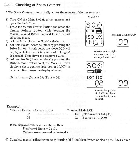

Please see the attached image for the instructions to view shots counter/shutter count of Contax G1.

Thanks for posting that! Just checked mine, 2887. Any chance it's easy to adjust the meter? Mine's consistently off by 1 stop, not that it's a big deal to use the comp dial.

Does anybody know what other letters and numbers mean?
