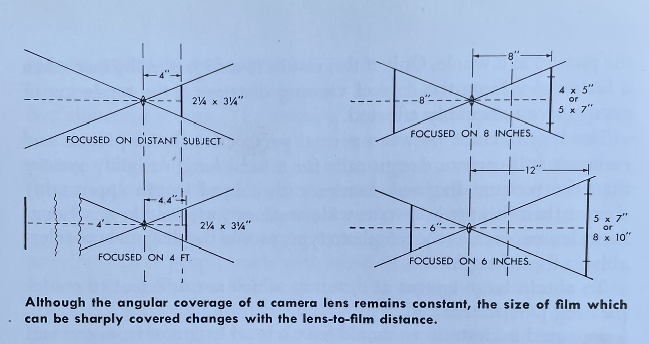

From an old Kodak Lenses handbook. It mentions your lens but not in detail.
This factual chart seems relevant. If you’re looking for ideas, it suggests you can do macro work. Maybe a portrait of the mermaid figurine from your movie.
For a 4 inch medium format lens:
