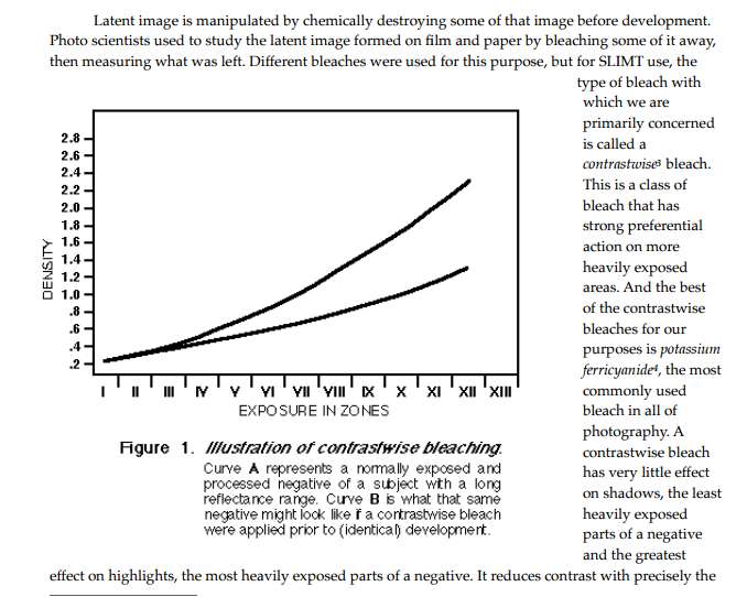

> SLIMT (Selective Latent Image Manipulation Techniques) http://www.davidkachel.com/assets/cont_pt3.htm. You may perform a contrastwise bleaching prior a pushing development, in that case you limit the contrast from the pushing development while conserving the "pushed" speed".
I've been experimenting with those 3 techniques for night photography, in that situation we have more LIRF in the shadows and a risk of excessive contrast...

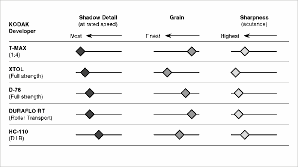

If you don't like Rodinal, you can do the same with HC-110 1+119, D-76/ID-11/Xtol 1+3, most likely Dektol 1+14 or 1+19 (you may have to extrapolate times for Dektol) -- pretty much anything where you can find times for high dilution. If you use a developer with phenidone (Xtol, for instance) you may gain more than 2/3 stop.
Bantam RF, Ultra 100 (828 cut from 120), Parodinal 1:50.
My tests show about one stop difference between a SLOW and a FAST developer formula. So, depending on your starting point on the spectrum of developer formulas, one could gain up to a whole step moving to a 'high-speed' developer. Otherwise, if one already uses a high speed formula (for example I use T-Max Developer) there is not much to be gained.
BTW: There us no standard developer for ISO speed tests. Manufactures can choose any developer they want for the test.

One interesting thing of SLIMT is that it conserves the result in the toe but it has the strong effect in the more exposed areas. Large crystals responsible for the sensitivity in the shadows are difficult to dissolve/bleach, while small crystals that add density in heavily exposed areas are quite easy to dissolve, hence the selective action.
Of course it is debatable if with other techniques we get something equivalent. A drawback is that some bleaching chem has to be handled with extra care.
Using Farmer's reducer after development won't be as effective in the compensation, as metallic silver is in clumps and we don't have those small/weak crystals anymore.

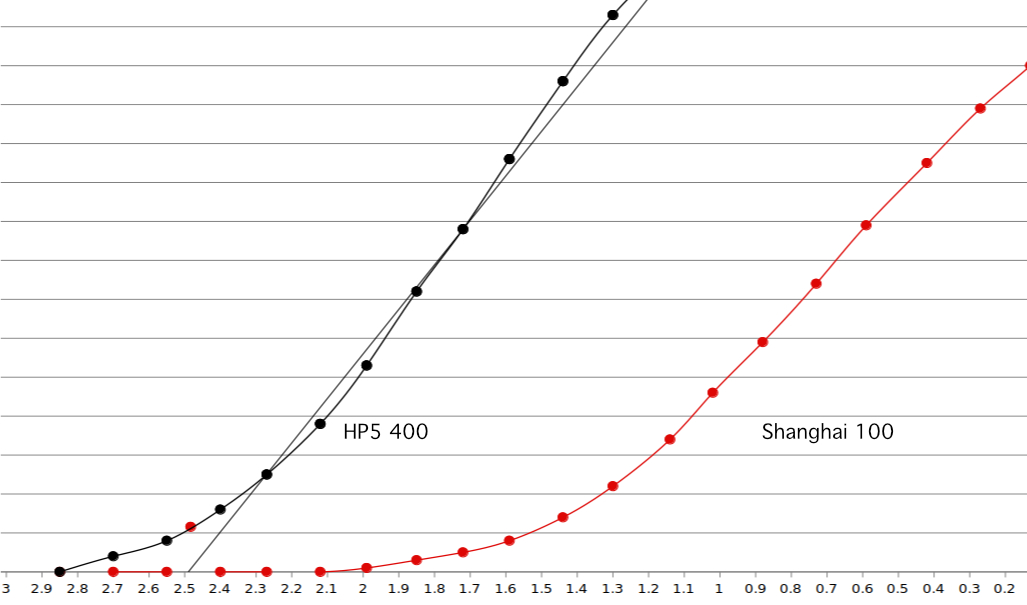

That's interesting. I can see calibrating a SLIMT process needing at the least a lot of testing (film cost, time) and probably wanting a densitometer to see what you're actually getting, but it could be a good way to get another stop out of a film/developer combination that's already at its limit -- for things like available-dark work in bars or poorly lit night streets...
If faster film is available, I'd go that route. One reason I look at methods to increase shadow detail (speed) is that all the inexpensive 8x10 B&W film I have used has very poor shadow detail, and frequently is a stop slower than the box indicates. And this is with T-max developer.
Obviously if 8x10 T-max 400 film were priced better, I'd use that and not mess with inexpensive 8x10 film.
On my 'to do' list is to try SLIMT with Shanghai 8x10. I was hoping someone else would do it. We are on our third COVID surge and I'm wishing for it to ease or go away so I have some time to do these things.
