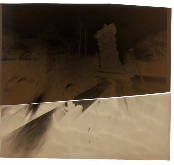

Scan of chrome
As I wrote before, I have cut up one of the chromes for some experimentation. I have know bleached and redeveloped (in paper developer) the chrome twice. See the attached image.
The upper part is the unmodified transparency as it came out of the D76. The lower part is the bleached and redeveloped transparency. Notice it has considerable more transparency and contrast.
It might be worthwhile to do the same to the other transparency and see if I can print something. I don't expect any great results, but it is fun to try out :tongue:

Well, actually, I am not attempting to restore to some sort of color negative or diapositive. As said, I just want to try printing the remaining sheet B&W. The bleaching at least seems to give a bit more contrast and removes some of the very dense (silver?) coat over the sheet.
I also neither have the chemicals, nor the facilities to do color processing...
