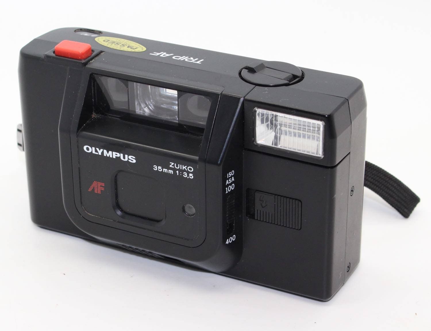

If price is important, why not one of the non-zoom plastic fantastics? Some, like the Nikon L35AF of the Canon AF35M have achieved a semi-cult status within a cerain crowd, with matching increase in price. But why not one of these (I'm partial to Olympus):

https://img.clasf.pt/2016/01/25/Olympus-Trip-AF30-20160125072648.jpg
do an e**y search with Olympus Trip AF. Of course, I don't mention the MjuI or MjuII.

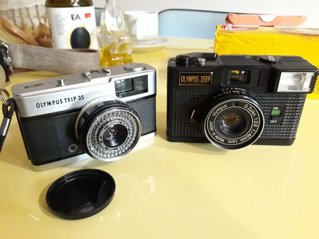

Thanks everyone. I ended up opting for the Trip 35. The XAs were too expensive here and I couldn't get any guarantees on the Agfa Optima. The trip 35 arrived on Friday and seems to be functioning correctly but I haven't yet tested it with film. Lens looks good. I like the fact that it's all mechanical. As well as a working flash, the seller threw in a second camera, an Olympus 35EF. It requires batteries but is missing the lid for the battery compartment. I haven't been able to find any serious information on it. It has a D. Zuiko 40mm f/2.8 lens, built in flash, adjustable aperture and no "A" auto setting. Would be great if it works in aperture priority mode, probably not. Anyone know anything about this camera? I'll attach a photo of the pair...
[edit] actually, looking again at it, on the other side of the ring with f-stop markings, it has symbols for sunny (f/16), sun/cloud (f/8), overcast and flash symbol (f/5.6) and rain (f/2.8). Perhaps then the camera has a single shutter speed. That seems most likely and in which case it should work without batteries as the shutter is firing without. The battery is probably for the flash only. But then, what ISO film should be used? There no way of setting it. My guess is 100.
[edit 2] and the light meter window at the top of the lens is apparently unused, so no meter

Here's an album of photos on flickr somebody (from Brazil, apparently) has taken with a 35EF:
https://www.flickr.com/photos/clara_santi/sets/72157606730930024/
And here's a link to a PDF from Mike Butkus's camera manual site for the 35ED, which appears to be an earlier, slightly more upscale version of the Oly 35. The two cameras appear to have several features in common, so perhaps you can intuit some of your camera's controls from this manual:
http://www.cameramanuals.org/olympus_pdf/olympus_35ed.pdf
My google search on the Oly 35EF uncovered several hits, but not one in English. Mostly Brazilian Portuguese, Spanish, and one hit in French. Puzzling.
Thanks, the Portuguese ones I read were either just selling or asking for information. Must have been a model sold only in South America (and France?). I wrote to that Flickr user too, but I think her last post was quite some time ago, so I don't hold out too much hope of a reply. What I'll do is make an audio recording of the shutter and import it into some software to try an estimate the speed. Should work and I should be able to estimate the best ISO to use. Cheers
