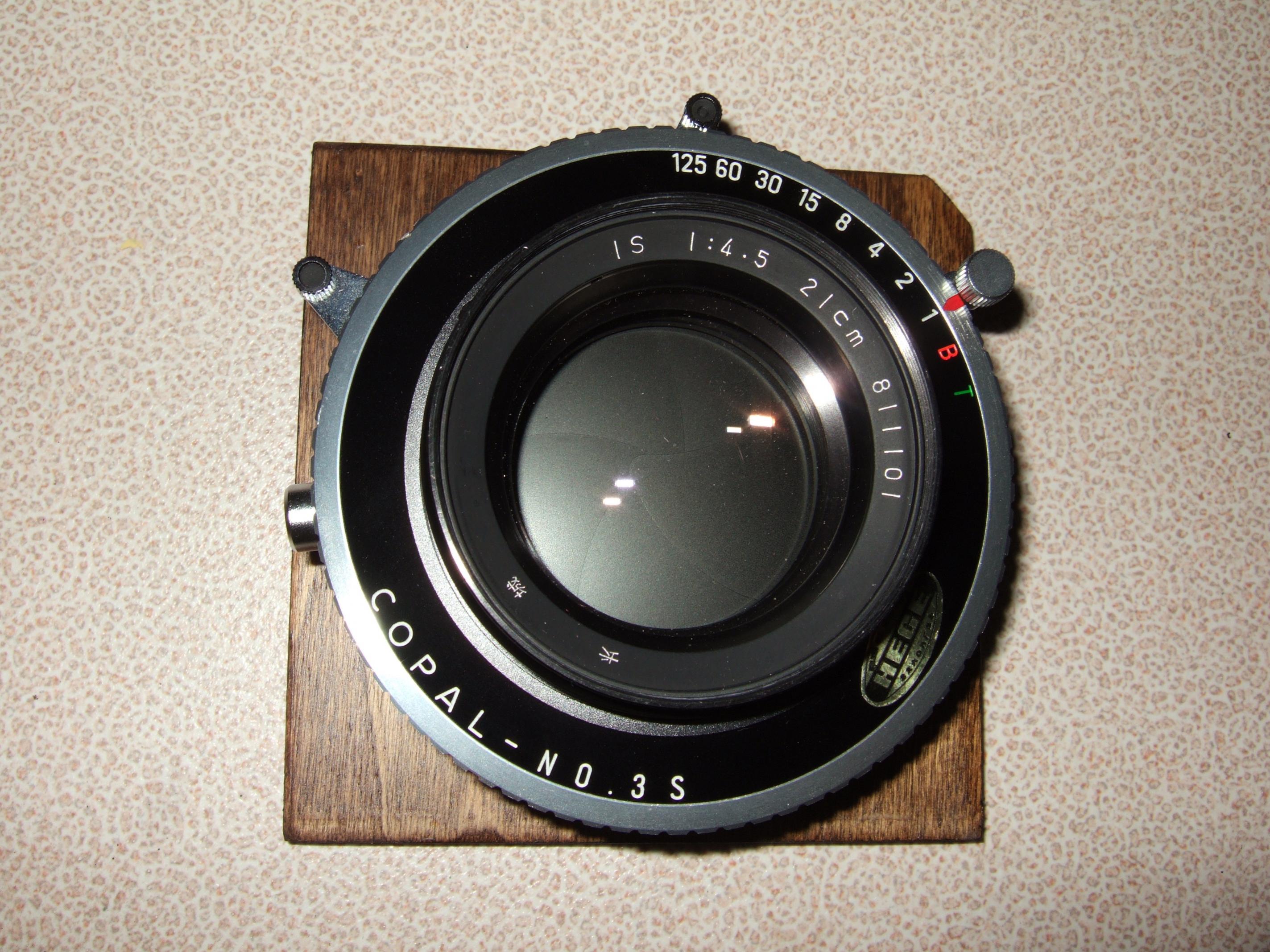

I bought this lens at last years Photographica in London but have just got round to using it. It came in a Copal 3S shutter and I assume it is a Tessar design. It covers 5x7 and is very sharp stopped down at f11 and beyond. I have been able to find out very little (nothing of use) about the manufacturer, when it was made or what/who it was made for. I believe it to be of Chinese origin but that's about all I know. It seems odd that that it should be in such a large shutter. I would expect a Copal 1 at this focal length and I did in fact buy this for its mint condition shutter.

A #1 can be too small for a 210/4.5, which may need an aperture as large as 47 mm. Remember, the #1 opens only to 30 mm. Perhaps your expectations were formed by 210/5.6s, many of which are in #1s.

Let's see a photo of the engravings on the lens and see if anyone has any idea.

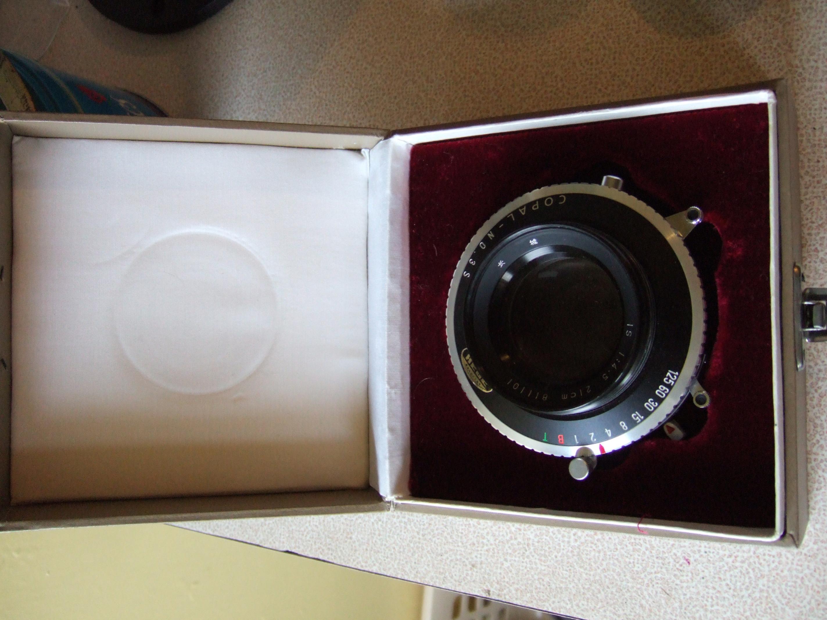

You could well be right about this lens doing the rounds of the camera fairs Ian. It came in a light brown box with a metal catch and a red plush interior.It was in extremely nice condition and looked unused. See Pics. I have shown the lens with close ups of the sticker and inscriptions on front and back caps.
It shows 4 strong reflections in the front cell set and 3 reflections in the rear set, 2 of which are strong and 1 of which is weak. Would you expect this to be the characteristic reflections from a Tessar copy Dan? I associate lenses around this focal length with an f4.5 aperture with Tessars.

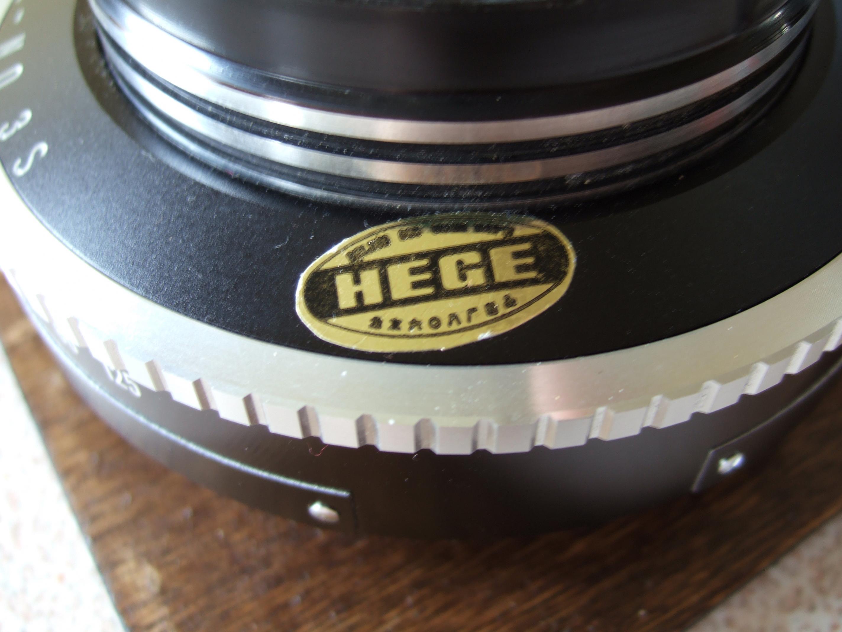

What does the text on top at that sticker say? It seems latin characters.
Steve S
Steve S
Oct 25, 2007
80
Newcastle up
Indistinct but through a loupe I think it says BEIJING COS CHANG CHIPIN. The last word is almost illegible so my best guess only.

My guess is it the lens I saw. It looks the same and I remember the stickers & the box. I think you've done well, should be an interesting lens to use.

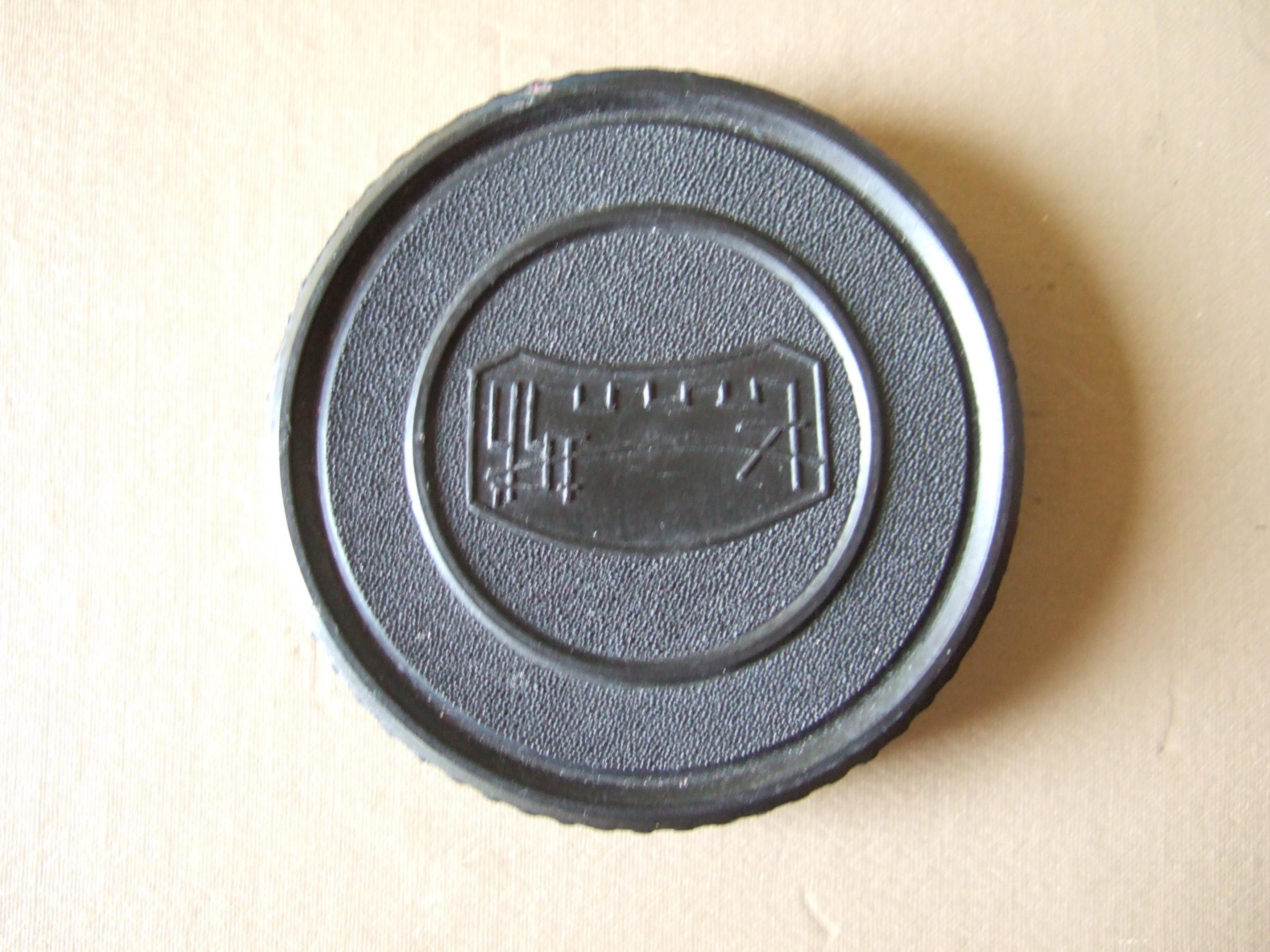

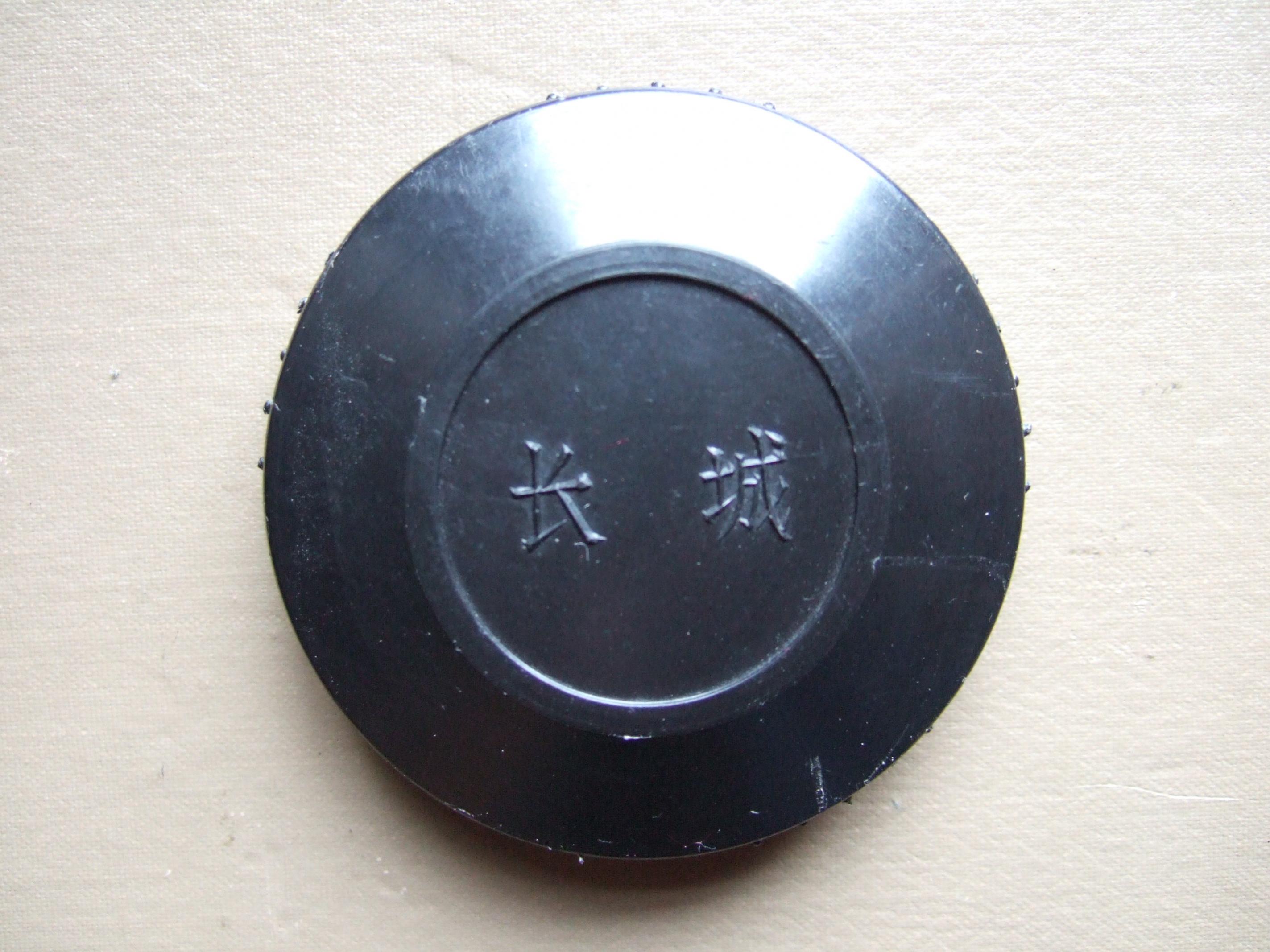

It reads "Great Wall".
That pretty much nails it as a product of the Beijing camera factory. " Great Wall " was the generic name given to all their products from around the 1970s onwards. It fits in nicely with the logo on the front cap too.This is what I love so much about photographic fora; a really productive use of the internet.

Just a side remark, I think the photo of one of the lens caps with the logo is upside down. If you turn it over, I think it shows the Great Wall characters half-peeping over the wall. This also makes the lens outline convex up, which is more common in logos for whatever reason (there is an old logo with a similar outline, I think Carl Zeiss).
