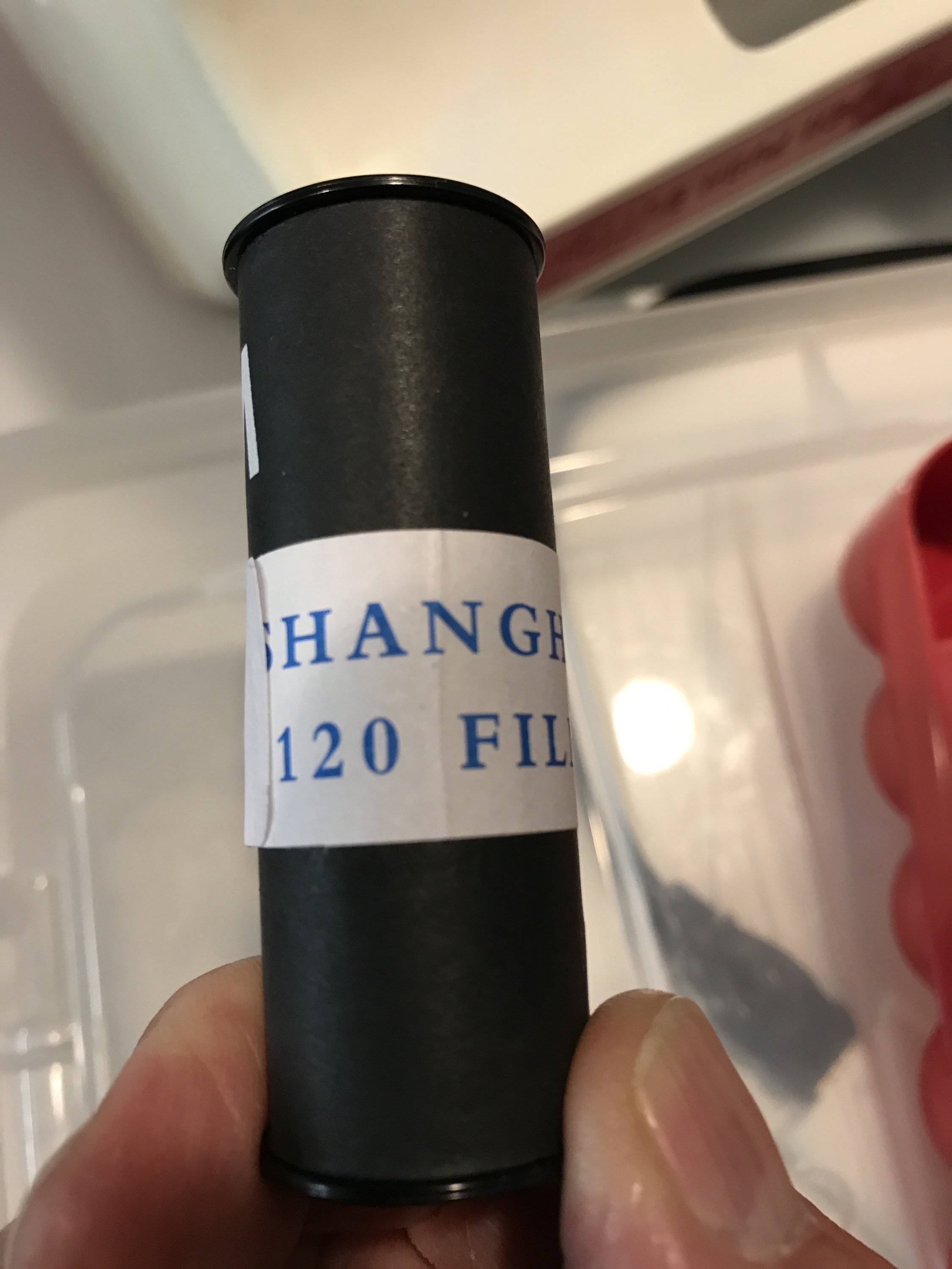

At least made in the same facility. This is the exposed end tape from a roll of CATLabs.

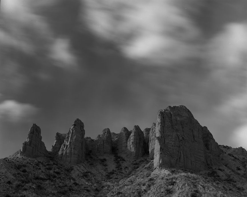

Here's a result from it in 8x10 sheet film:
full
I'm seeing a lot of talking about the film without any results to validate opinions. I don't care if it is GP3 or something custom. I do care that it produces results, which it does. I got it because I wanted a slow film to shoot in my 8x10 with lenses that don't have shutters. It perfectly fits that bill - I rate it at around ISO 25, process it in Pyrocat HD 1:1:100 for 14 minutes at 75 F. That produced the above.
