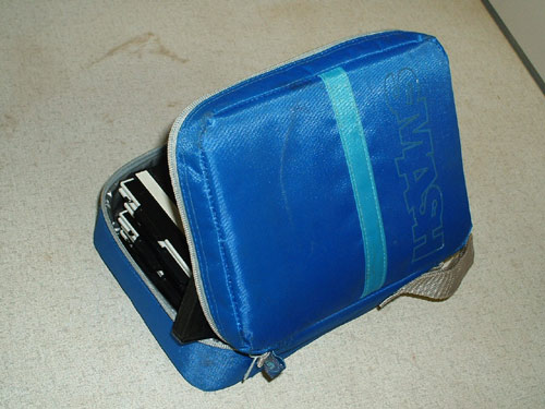

I use the medium sized Stuff Sac from Eagle Creek which can be found at REI Coop. They hold 3-4 4x5 holders or 2 grafmatics and are pretty dust proof. They're zippered and they have a plastic hook/latch that you can latch on to your tripod as you're working.

these are perfect. I bought two yesterday using the remainder of my REI dividend. perfect use for it.
