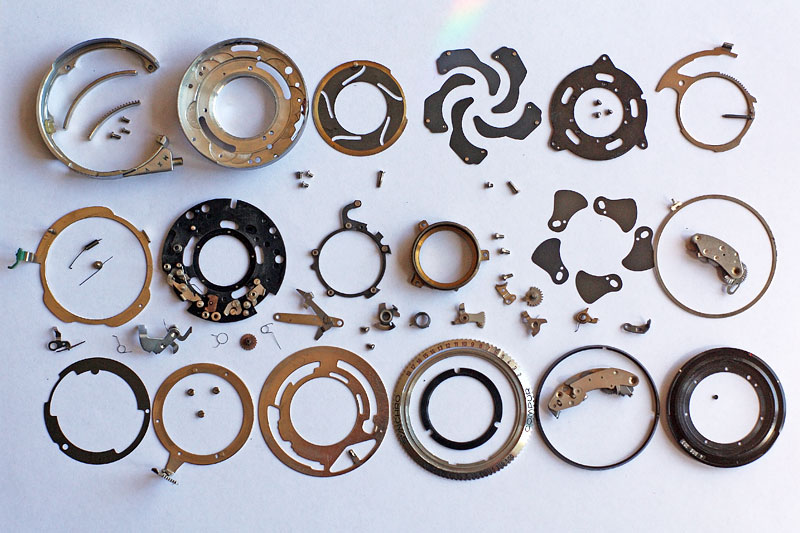

OP wrote: What is the chance that I could, as a non camera repair person with no special tools, figure out how to clean and lube the shutter with out ruining the camera?
The condition of the shutter he is describing needs a stripdown cleaning for lasting results. A few drops of lighter fluid on the escapement may get it working for a while but it will start dragging again before too long. His placement in sun is doing something similar- causing the gummed-up lubes and dirt to lower viscosity slightly. Remove heat/dry out fluid, and back to slow.
Here's a Synchro-Compur stripped down to the level needed. Does this help explain why people are suggesting to not do this? And this doesn't even touch getting the shutter out of the camera itself.
image from: https://retinarescue.com/synchro-compur.html

All right!
Now we have a picture 😌

Yes that is clearly the consensus, and I am convinced. I have taken the front off both my 2.8F and FX to clean the lenses and that was pretty easy/ zen and the art of camera maintenance. So I thought perhaps if I took the front off the Rolleicord I could find a spot that a drop of 3 in 1 or a bit of lighter fluid would fix it at least temporarily. But apparently that is not an option, there is no spot to lube. However that was the reason for my posting the question.
