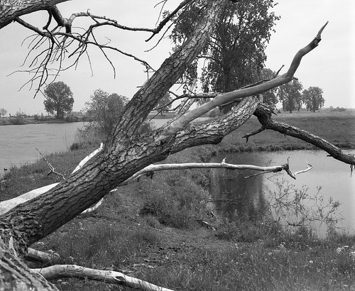

Two examples in 35mm and 6x7cm rolfilm. Same film (Retro 100 Tonal).
First example is developed in CG512, a liquid (Metol type) ultra fine grain developer (Udo Raffay), fine grain, a bit lack of sharpness and these type developers gives always some speed loss, in this case E.I. 50.
Equipment: M7 (Leica RF) + Summicron 2,0/50mm, in principle one of the best 35mm lenses available.
Second example is developed in AM74, a liquid Phenidone/Hydroquinon semi-compensating developer (Amaloco, Jaap van Beugen), where this developer gives more sharpness then a particular fine grain.
Equipment: C.V. Bessa III 667 folder RF.
Two different (light contrast) situations: A high contrast scene. (Even with strong backlight) and Low contrast, foggy weather.
Same scanner V500 (Epson) resp. 3200dpi, 2400dpi. Hopefully you can see what is meant by grain, acutance, sharpness and high definition.
I'll just add that I would not use an ordinary (non drum) scanner to judge sharpness
Well you see already how difficult it is.
