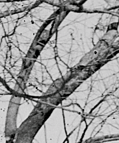

I recently returned to the world of film and chemistry after a long hiatus. I shot a roll of fresh 120 roll of Tri-X, and developed it in Rodinal 1:50 as I have many times in the past. Instead of Kodak stop and fixer I would have used in the past, I used Ilford Ilfostop and Rapid fix at the specified film dilutions. All chemicals were at the same temperature as was the wash. The negatives were a bit dense for my liking @ 12m/20C, but they're reasonable enough.
Upon closer inspection however, there are pinholes in the emulsion that are causing black spots in the reversed images. Using a loupe and light table, it almost looks like the emulsion has simply flaked off. I didn't abuse the film while loading; I had no issue loading/using the same stainless Nikkor spirals and Kindermann tank I have for years. I've simply never seen anything like this.

These weren't air bells, but tiny pin-holes. Also, I ritualistically rap my tank on the counter 4 times after every agitation cycle. I learned the hard way what air bells look like as a kid. I never presoaked Tri-X in the past and never had issues. I presoak Fomapan, but only to get the festive blue/green anti-halation dye out of it.
Don't mind the halos; I had a NASA Mars mission moment and range focused a Russian Moskva-4 marked in meters with my imperial minded brain; the unsharp mask is cranked way up.
Then I think you should contact Kodak Alaris about the problem. The shape of the spots discounts dust on the film at exposure time and the only other cause I can think of is tiny droplets of fixer or some other chemical reaching the film before development, which seems unlikely to me. I hope you find the cause, good luck. :smile:

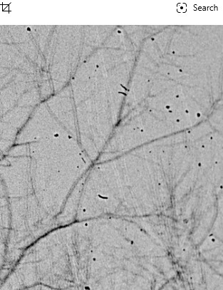

Attached is the image fragment they returned to me. Do any of you have an idea what those "lines" are? The responses I've received from Kodak Professional have been unsatisfying, to say the least. Maybe it's time to give HP5 and Fomapan 400 another shot.

They could be micro-reticulation, very small wrinkles in the gelatin. It might also explain the odd spots on your negs. Reticulation is generally caused by a temperature change during processing. Modern filmstocks aren't as vulnerable to this as older types like Tr-X. The link below (Ephotozine) shows a couple of examples of regular reticulation used as a creative technique.

This isn't' reticulation. The negatives and images are otherwise perfect except for the missing emulsion spots. I took care to ensure all my chemistry was at room temp (68F by happy accident) and got the wash water within a couple degrees of that. However, I am starting to suspect, as anachronistic as it sounds, that Tri-X needs a hardening fixer. That's the only remotely plausible thought that comes to mind.
