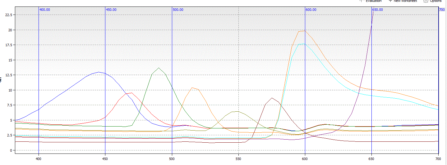

The visual spectra of these filters is:

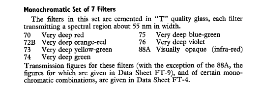

The best match I've seen among filter spectra so far suggests they are 'monochromats' but I can't currently find my Wratten handbook for a more detailed explanation.
All seem very dark & I can't help wondering if the lower transmission near the eyes maximum sensitivity (550nm) is deliberate.
Another Kodak handbook has the following about their monochromat set:

That's quick work there! Many thanks. I only posted them on Saturday ;-) . It's amazing to see the spectra there, even though my understanding is at a very low level...
Iain
They arrived Monday morning & the light was poor during Monday & Tuesday lunchtimes so I didn't have too many distractions. :smile:
I've got visitors at work the next couple of days so might not be able to get to the post office till the weekend.
