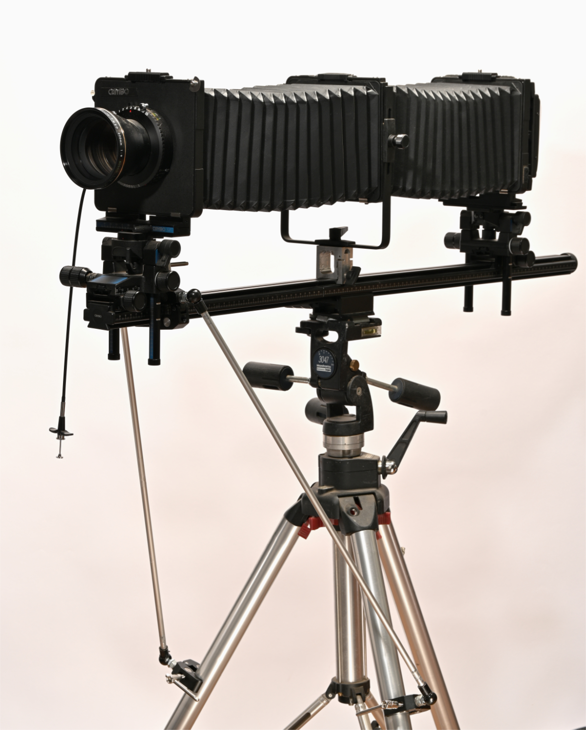

Berthas are long lens SLRs. Your image shows a long lens camera. Where's the SLR module, and which SLR are you using?
My Baby Bertha's SLR was a 2x3 Graflex RB Ser. B. I made the rig to use a 900/10 Apo-Saphir. It was a disaster. Read about it at http://www.galerie-photo.com/baby-bertha-6x9-en.html
Mal Paso
Oct 14, 2019
374
Carmel, Ca USA
Oh, mine is a 600/1200mm 4x5 with a Nikkor f9-19 telephoto, no reflex. I couldn't find a center support either and converted a SC one to SF. I bought a small mill and made the rail clamp from a block of aluminum. The rail is 42" with extensions and focuses to 5 and 25 feet. I made 2 struts to stabilize the camera from wind and vibrations.
