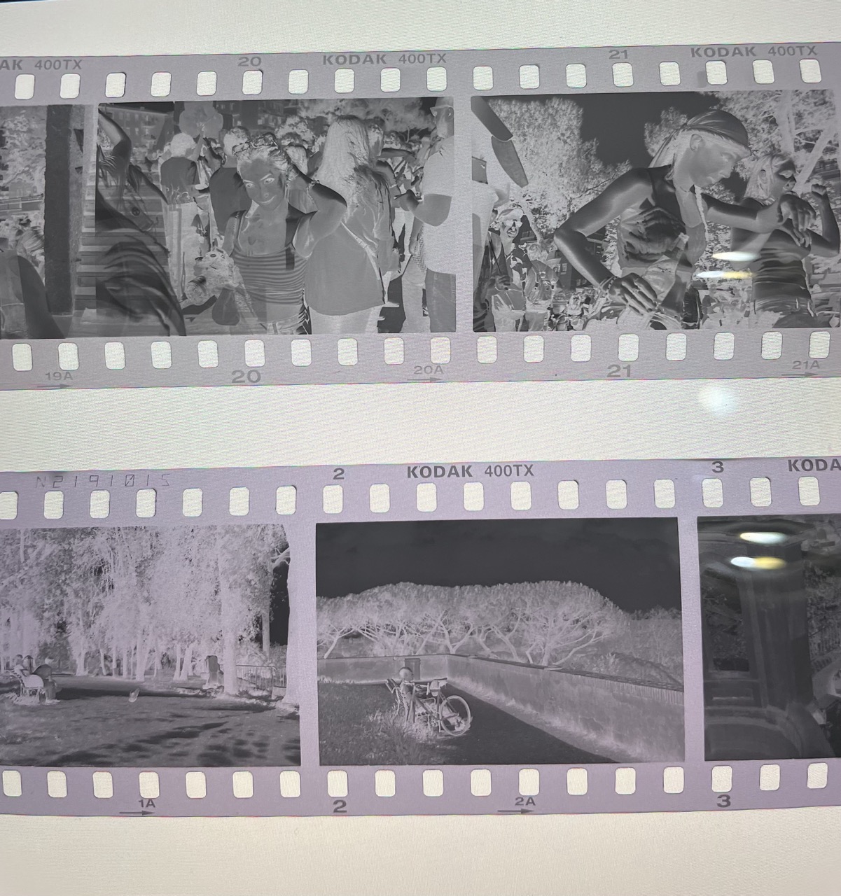

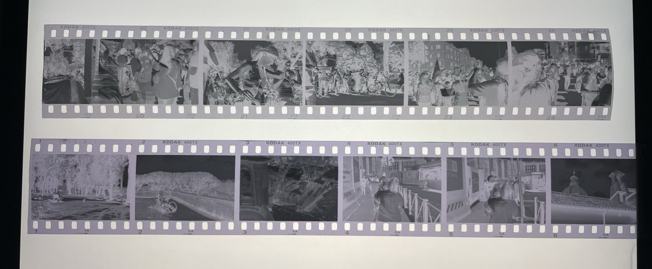

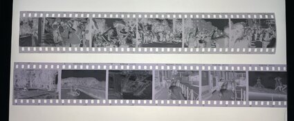

Hello everyone,
I am currently trying to calibrate my development times for Kodak Tri-X 400 in HC-110 at 20°C, but I am hitting a bit of a paradox between the two test strips I recently developed. I've attached the images of both negatives to this post.
Looking at the rebate markings, it is clear to me that one strip is significantly underdeveloped and the other is possibly overdeveloped.
Here are the details of my process:
  • Top Strip: Developed using Dilution E for 8m at 20°C. The rebate markings are very faint and greyish, and the overall negative lacks density and shadow detail.
  • Bottom Strip: Developed using Dilution E for 9m 45s minutes at 20°C. The rebate markings are completely black, and the highlights are extremely dense and hard to pierce during scanning or printing.
I am aware of the widespread consensus that Kodak's official published time for the new 400TX in Dilution B (3.75 minutes) is notoriously short. Because of this, I wanted to move to a higher dilution like Dilution E to get more manageable and controllable times.
Part of my confusion stems from contradictory information found on the well-known Covington Innovations HC-110 resource page. He explicitly states that most photographers recommend about 6 to 7 minutes for the old Tri-X in Dilution B and the new one is only a few percent shorter than that one, however, in his own data table, he lists 6.5 minutes for Dilution E.
Theoretically, if a proper Dilution B time should be around 6 to 6.5 minutes, Dilution E (being 1.5x more dilute) should require around 9 to 9.5 minutes. This aligns with why my 8 minute attempt turned out so thin.
Given these results, I would love to get your insights on two things:
  1. Based on the attached negatives, what specific development time would you recommend I try next in order to hit the sweet spot?
  2. What are your personal go-to times and dilutions when developing the new Tri-X 400 in HC-110 (especially if you use Dilution E)?
Thanks in advance!
To get more shadow detail over expose a half a stop or so. In terms of development, do they look good when printed on grade 2 paper or lower?
To be honest, I only made a couple of quick test strips under the enlarger using and neither printed well.
The top bottom is so dense that by the time I give the paper enough exposure to get any detail in the brighter areas, the shadows just go black and lose all texture.
The top negative prints rather flat and muddy, the shadows lack any depth, and the whole print just looks washed out, with low range.
