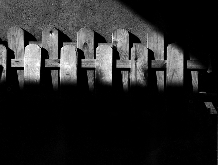

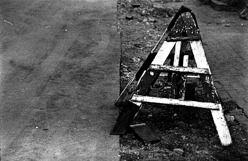

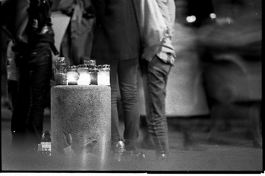

PS. I've attached, my 800 EI rodinal pushed kodak 100.
PS2. IF you are interested, I can also show you some extreme pushes like 1600/3200 :smile:

BTW: It can be seen in scans that you're not agitating. Uneven development can be seen as lighter band on the scans you've posted.
