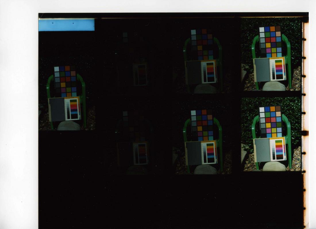

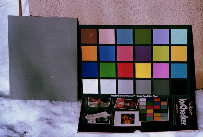

    As discussed for components, namely bleach, there are alternatives to kit or "official" C-41 chemistry. I am attaching a test image as example.
    The image is a direct scan (Nikon LS-3500) of a small portion (about 1/8 frame) of an image taken of the MacBeth chart and an 18% grey scale card. Processing was done using entirely scratch-mix alternative chemistry. Bleach was Fe-Ammonium EDTA. The particulars for this image are:
    Minolta 7000/50 mm f/1.7 lens
    illumination direct sunlight (6800' elevation)
    ASA-160
    Portra NC
    ~1/8 frame scanned at 300 dpi/scaled and converted to .jpg attachment
    no scanning color corrections are applied
    Perhaps others would like to provide examples for discussion?

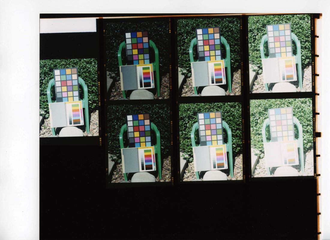

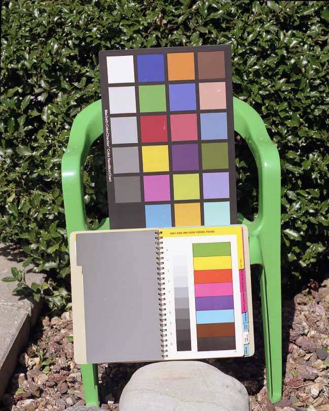

    Considering the manipulation of the scanning process itself, turning a negative into a positive, we then have to consider the results from various scanners.
    Here is Portra 160VC in authentic C-41 chemistry. It was shot at ISO 160, on 120 film in an RZ67 with auto metering.
    I edited this to include a larger version.
    PE

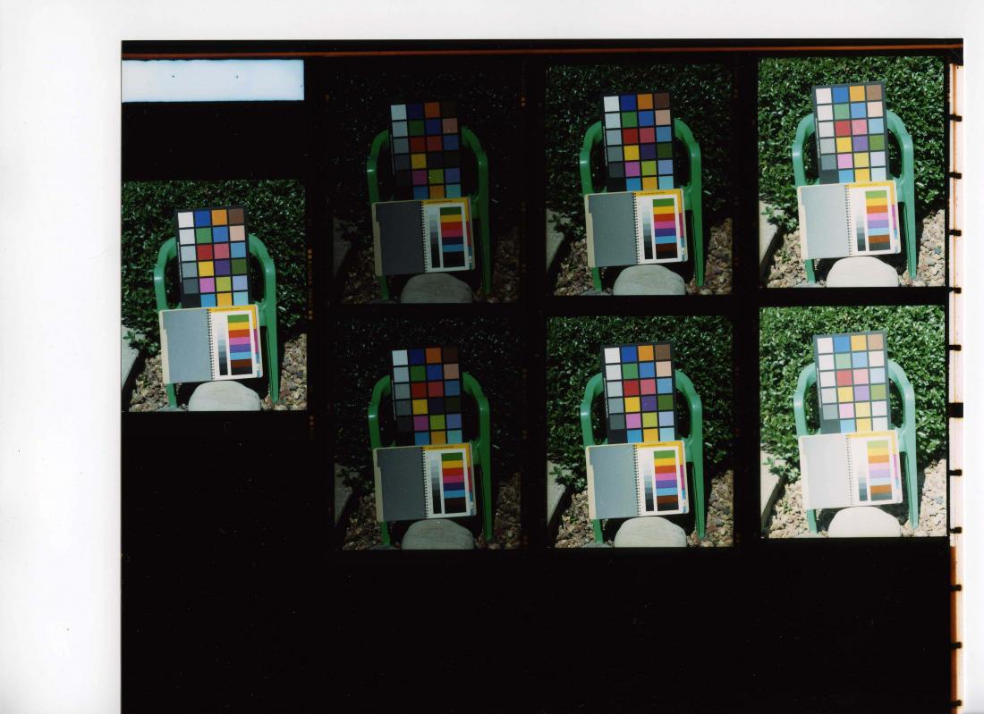

    Here are the proof prints on Endura Supra.
    I exposed these at f11, f5.6 and f16 respectively to emphasize the different speeds of the film used.
    The range is ISO 25, 50, 100, 200, 400 and 800 with the reference posted above at 160 shown at the top as a single photo. The correct exposure for this film is the ISO 160 with the print at f11. It reproduces a lot zippier on the paper than it does in a direct scan.
    Contrast and brightness manipulation would make the scan match the print. IDK how yours would print due to this type of problem. As you say, scans are all we can rely on.

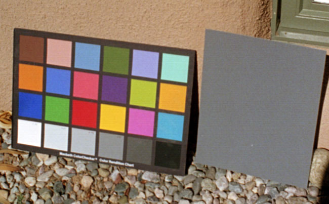

    It's amazing how good Kodak films and the other current emulsions really are. The Portra 160NC image I posted required only a minor color correction whereas the recent test attached here took more correction and does not have the nice parallel characteristic curves of the new emulsions. That is to say there is a bit of cross-over in the toe and shoulder, but some of that could be attributed to the fact that the film sat in my freezer for a good ten years or more. This example is Fuji Super G-100 that I got really cheap in a 100' roll from FreeStyle a long time ago. It was processed in the same chemistry as the Portra 160NC example I posted earlier.
    The grain is much more noticeable and under magnification the color layers are not nearly as uniform as in the modern films. Still, the colors are there and the processed film produces acceptable prints, although nothing that you would like to enlarge very much beyond say 5x7" size.

    Well, another factor is that all C-41 films are supposed to react to C-41 identically as much as is possible to all parameters, but this is not true for home-made developers.
    So, I have seen cases where two films are identical in Kodak and Fuji chemistry, but only one of them "works" in a home made developer.
    I once ran a similar experiment with several coatings of color developer and 12 different developer formulas. The papers were all the same in the genuine Kodak color developer, but each paper gave vastly different results, similar to the problems you saw above, in the other developers. However, one paper was correct in at least one of the other developers.
    Perhaps this is what you are seeing here. It is can be due to emulsion thickness, coupler types, correction chemistry, and Iodide content in the emulsions. All of these cause varying reactions to the chemistry.

    The technique you mention is called a factorial and you use statistical analysis to examine your data. I did not agree with a lot of Chapman's writings, as he had missed a lot of information. Pat Dignan and I discussed his use of CD-4 in rapid access print processing. I pointed out to him that there would be a severe loss in dye stability and I knew that simply because I had run a large "factorial" experiment on developing agent vs coupler for the patent for CD-6.
    Now, as for the results above, my point is that all films of the C-41 family should behave alike in a "real" C-41 developer. If they do not, for any reason, then the developer is wroing. Since all films are released to have no crossover, then an ISO 160 and an ISO 800 film, tested as above should give no crossover and really should behave alike to push and pull. This result should be the same across manufacturers, as they release film to the same standard.

    The alternative chemistry produced a very good looking result, although I prefer the look of PE's authentic chemistry. One thing I noticed for both the NC and G100 scans was that the saturation was much higher than it was in PE's scans. That could be the scan or the developer. If it is the developer, it is a significant effect.
