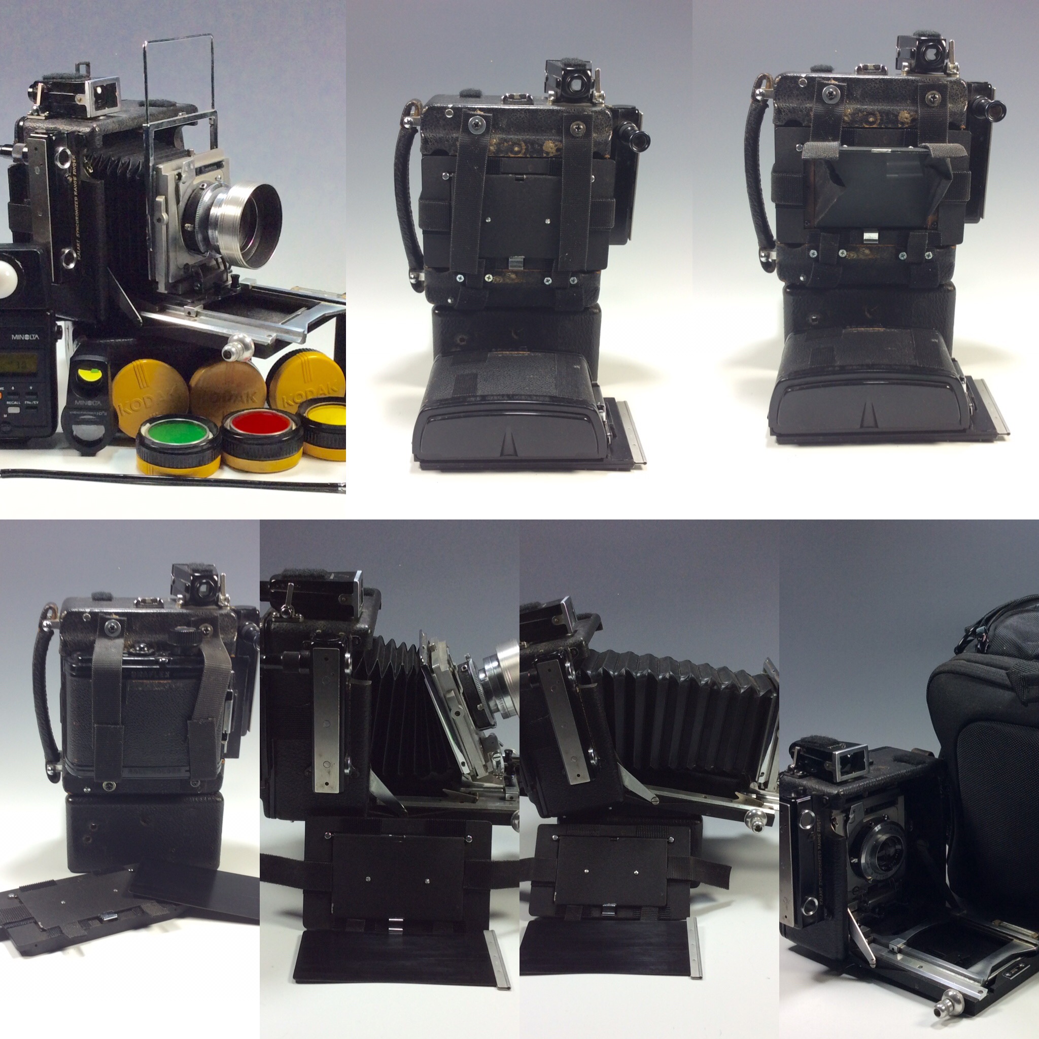

I'm new to the forum and have just acquired a near mint Model C, which I'm almost done modifying to use Graflex RH8 roll film backs along with the Grafmatic 23 Back (6 sheets film holder) without have top perform any surgery on the camera body and cost me about $10 for the muting hardware and about 2 hours of my time. It should work on any 2x3 Graphic/B&J with a Graphic/Graflex back. I have a 101mm Wollensak in a Rapax shutter but want to add something wider and longer. Anyone have luck finding lens boards. Mine has the one with the metal bar that has to go in at the top and two screws at the bottom. But it looks it will take a lens board with four screws in the space behind the metal board when its removed. Has anyone done this?
I'm finishing the mods for the back later today and if the rain stops I'll shoot some photos and post them with the different backs attached.

Had to take some time off for hip replacement #3, now I'm balanced again. The mods are finished on my BP Model C, chemicals are in and the film dryer is finished. I was able to score 2 more Model C's for parts and extra lens boards; some I'm good and was able to sell some parts to cover the cost of the cameras. I have a nice Raptar 101mm and looking to acquire a junck lens with a good shutter to build a pin hole for wide angle shooting. Will start shooting this week now that I can walk again.

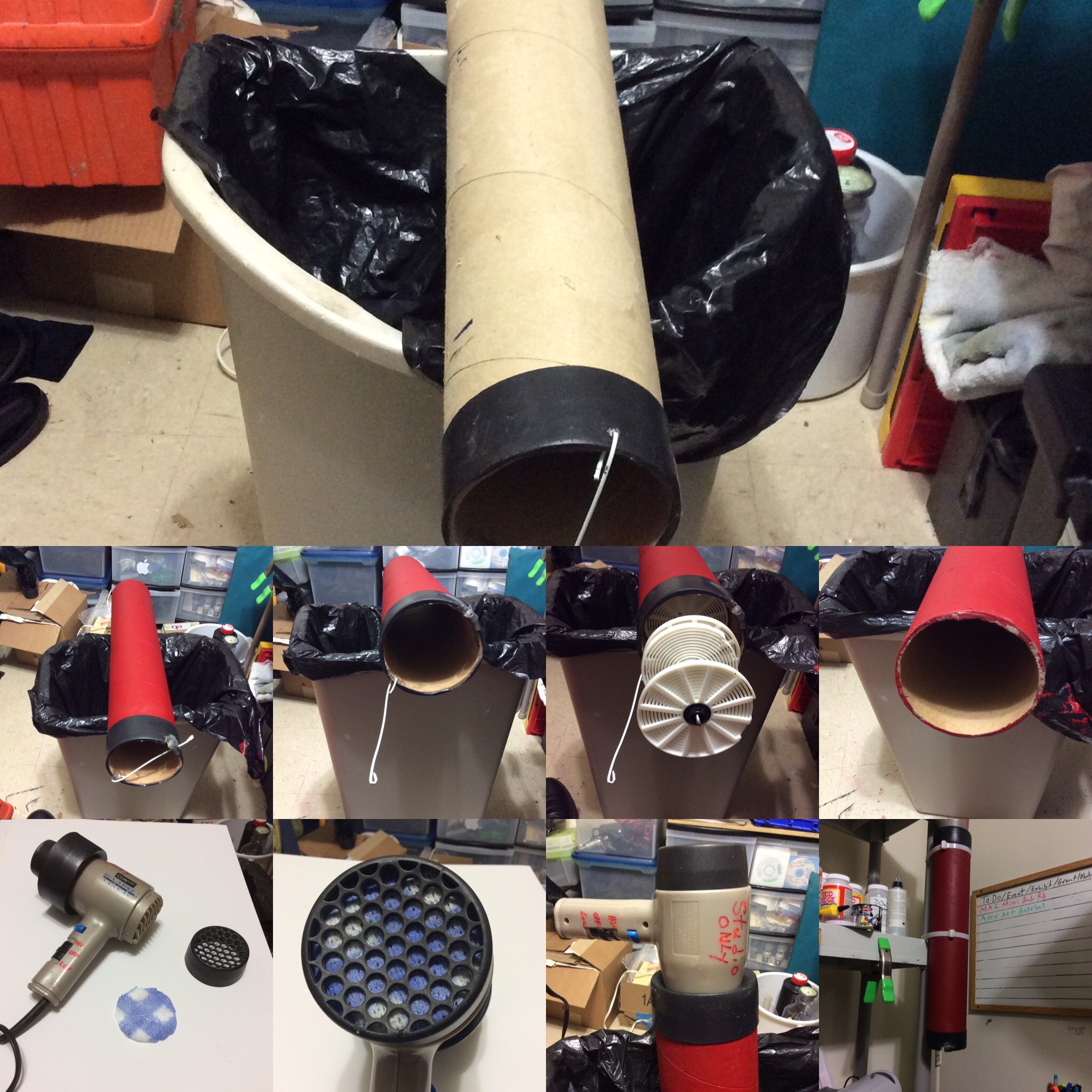

Here's the camera with all the accessories I've gotten from eBay and Etsy. The Graphic RH-8 backs and ground glass are held on with Velcro, decided not shoot sheet film. Processing will be with Unicolor ll Film Drums, which I have 3 and 6-120 reels that are almost impossible to find. I'm on the look out for more reels and a Simma Sine Wave roller base, which I almost impossible to find. I missed one recently and have learned they were also sold under the Linhof name. As the tank rotates in one direction it rocks along its horizontal axis. I've had this one since 1997 after finding it in at San Francisco camera swap. Will post photos later, but here's the film dryer ready to go. Will be back after shoot my first rolls.

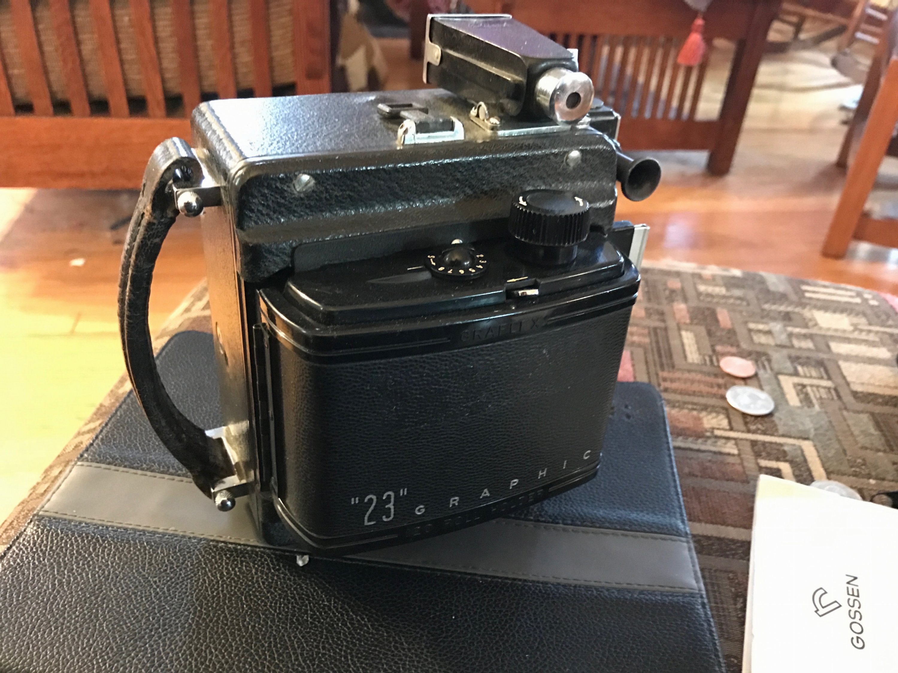

I use both a Graphic 23 and 22 roll film back on my Model C. With the proper back and the (hard to find) attachment clips, this is literally a 30 second conversion from the spring back.
