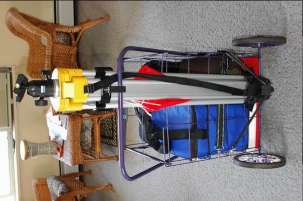

Me and my in-pain spine decided to stop hauling around my 8x10 camera so we looked for some alternative ways to accomplish this task.
I was out photographing with my friend Andrew O'Neill last week and my 8x10 tachihara+6 holders+ann the extras+my massive surveyors tripod felt heavier and heavier by everyminute i spent walking. At the end of the day i sat on the sidewalk and asked god to take me..
So i went on a quest to carry all that equipment around.. the answer started in cnd tire and the california innovations cooler that holds my 8x10 tachihara+6holders+darkcloth perfect. Then i went in to my shed and dug out an old granny cart and cleaned it up and painted it. the result is in the pictures. My tripod mounts on it perfect and my back is laughing.
I also put in my old shoulder bag that carries my 2 lenses + filters+light meter and some other extras. the front hand bag has my spare film and storage film box.i made a baseplate for the cart from cardboard and covered it with red fabric. and i also have my fuji film sponsored cushion.
I will never backpack with this gear unless i really have to.

What do you do if you need to haul it up a rock face? I love your idea but I find it limited to flat or nearly flat locations. Most of my nature shots are deep in the forest where there is no laid out path but uneven terrain OR where I need to do some rock climbing. Eventually one needs to look into a four-wheel drive version of this. On the other hand, yours spine is more important than any ground breaking photo op.

Deniz, Francisco makes a good point, a grocery cart is limited. I can offer from experience what does work well over very rough terrain and that is a bicycle trailer (bugger) with a handle bar. Keep your eye out for one that is used with good wheels. Many different models are manufactured, but only those which are the lightest are suitable. 20 inch diameter inflated tires will roll over medium size cobbles and boulders with little effort. If you need to haul up over larger boulders, the rig will remain stable and roll, unlike the grocery cart which offers only its wire face to rock face. See if you can borrow one from a cycling friend. Get a bit of static (non-stretch) climbing rope and a couple of jammers. Go to a climbing shop and they will show you how to use the jammers to haul that cart efficiently over obstructions. Go to an Army surplus store and look for an old aluminum electronic packing case (waterproof). The Navy and Airforce had such cases for all sorts of technical gear. You should be able to find one large enough to accommodate everything except your tripod. Bolt that to the cart and you are in business. Plus, you have something to sit on when you get tired. Just a thought. Regards, David.

If i had the funds to buy a bike trailer, i would spend a little more and get a nice lowepro backpack..
As i said i will backpack with this stuff if i have to(rough terrain and hiking in the forecast) but otherwise i will be pushing/pulling my granny cart to whereever i take my 8x10 to :smile:

Deniz, you might also look for a stroller/jogger at a garage sale. They generally have 3 large tires which can handle off-road terrain nicely. The seat for the kid is just right size for a camera pack. And they often have a mesh pocket in the back for water, snacks, whatever.

Taking my 2 year old son out shooting with me can be a bit of a pain sometimes, as he doesn't have the patience to sit with me while I fiddle about with my gear. There is one advantage though. I can stuff all my gear in his stroller, which makes it much easier to haul around. The stroller we have wasn't intended for unpaved paths but I find I can easily tip it and pull it when needed and light enough to pick up the entire thing and haul it over rougher terrain. Granted, I haven't tried hauling it up any real steep terrain but and it's a nightmare job pushing it through uneven terrain if my son gets tired (but it helps keep me in shape).

If you want to see a nice cart, you should see the one Oliver Gagliana uses in the video biography on him. Big tires and he hauls around a lot of stuff for an 80 year old guy. Not good offroad, but those days were behing him then. For me, I'm 50+ and I can still pack all that 8x10 stuff and Reis tripod up and down trails. Knock on wood.
