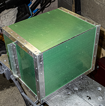

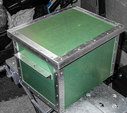

Attached are two images of the aluminium dispencer The basic measurements are 12" tall x12"wide x13"long inches with a lid about 1/2" wider and longer
The basic construction is 1.5mm alloy sheet with 25mm x 25mm angle strip all pop riveted together with black mastic sealing applied on the inside of each angle strip to assist in excluding the light. The top edge has 10mm wide self adhesive foam strip applied along each inside edge to make the lid and the box light tight. Image 2 shows the slot which the paper is pulled with the emulsion face down (It is rolled by Kodak with the emulsion facing outwards). The slot is lined inside with 1 strip of black felt glued to the front plate. The roll is suspended on a 2" diameter wooden dowel resting in wooded 'U' shaped bearers. and lubricated with candle wax.
The front slot when not in use is covered with a VERY close fitting piece of the same angle strip that formed the edges, again lined on the inside with black velvet. I did have a problem with some light getting in at first but this was found to be coming in via the pop rivets so they were also treated individually with the same black mastic.
The green colour was the protective plastic attached to the alloy sheet.

Thanks for sharing this. It's interesting to see how you did it.
