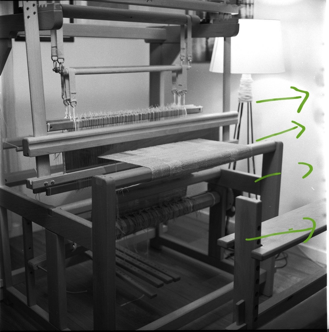

I have been developing my own film for a few years now, but my last few rolls of 120 have had some strange artifacts. :sad: The negatives have dark circles and blobs that run along the side of the negative without manufacturers markings (Fuji ACROS 100). I have included a sample one of the images with the problem.
A few details on my setup:
Camera: Yashica Mat 124G
Tank: Paterson System 4
Developer: Relatively Fresh XTOL Stock
Any suggestions would be appreciated, than you.

Could be a camera light leak as it is only on one side; 120 film, if it spools loosely, will typically have some light leak blobs along both edges.
Dark areas in the positive are areas of lower density in your neg, light leaks would produce high density.
Airbells seem like it might be most likely. Sometimes residual wetting agent on the reel can be a cause, or you may need to be more vigorous in tapping the tank to dislodge any bubbles when you fill with developer.
Are you filling the tank, if not, then one edge might be slightly out of the developer.
You posted a positive image, and the blobs are darker than the image, meaning that the blobs are lighter on the negative. If so, they cannot be light-leaks.
I suspect the developer is not covering the roll in the tank. Did you put at least 550 ml of XTOL in it? Also, when agitating a Paterson, the spool can creep up the centre post some. You can fix this after each agitation by thumping the tank downward against a hard surface or the palm of your other hand.

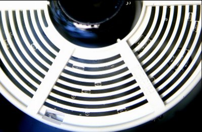

You can check your own water by just filling a pint glass, there will often be bubbles that adhere to the wall at all depths, tappingetc doesn't dilodge them all.
This photo shows bubbles after a pre-soak, with plain water it's not a cure.
I was using Pyrocat HD and no amount of tapping, inversion agitation would remove all the air bubbles, actually the best form of agitation was to swirl the spiral that did help remove far more of the air bubbles. I was able to do repeated testing to see how best to eliminate my own problem
Commercial developers are balanced in terms of sequestering agents etc to cope with most domestic/commercial water supplies but there can be extremes. But care with agitation a combination of inversion anda twisting action to get the developer to swirl a little makse a huge differance.

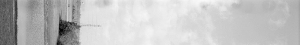

Hi Ian,
Thanks for your advice. I've the same problem, I suppose... I read very different theory about that, but the bubble of air seems to have sense! In Milan, Italy, I have hard water too. I'll try to change my agitation scheme and I hope this damn problem disappear... I use 6x6 on my Rolleiflex 2.8f.

Hello everyone,
Today I scanned the film pay attention at:
  1. slow develop movements (one minute), I'd changed my movements (now using a type of spiral "Jobo" movements and normal slow inversion, less Paterson kicks)
  2. normal agitation for Stop and Fix (maybe some more agitation on Fix fase).
Results: every 12 frame are perfect!
I hope this new method will be fine for the future. I really say thanks everyone has comment this thread, you have save my rolls!
Francesco
