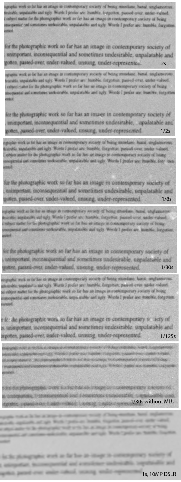

Ok, so here are the results from my GS-1 vibration test. GS-1 mounted on old (but solid) silver Manfrotto 055 tripod with 115 head at somewhat below head height with no column extension. Tripod resting on hard tiles over concrete floor. 100mm PG lens, focus and aperture (f11) not changed throughout. Mirror lock-up and cable release used on all but one shot. The film was Fuji Pro160C. Each shot was enlarged by exactly the same degree (a lot) onto Multigrade paper and the print scanned on an Epson V700. The scans have been cropped and down-sampled a bit (all by the same amount) for posting. There were some slight exposure variations at both the shooting and enlarging stage, which I have equalized in the scans, but I have done no sharpening. I also took a reference shot with a 10MP DSLR (K10D) in raw, mimicking the composition with the Bronica, just to get an idea of the difference in detail possible with the two formats. I'd say this shot is as sharp as is possible to get with that sensor. The crop of this shot has been scaled up to the same size as the others.
Hopefully the images will be viewable on screen at 1:1 (100%).
To me, it's clear that vibration is reducing detail significantly at 1/8s, 1/30s and 1/125s, with the peak being at 1/30s. It's a shame I didn't test 1/250s because I'd like to know whether the problem has gone by then. Even 1/2s is slightly worse than at 2s, I think. Ok, I realize it's quite subtle, but it's there, no? I'm sure that many people will consider these effects to be insignificant in real photography, which is perfectly valid given the number of other factors which can limit sharpness, but personally I find that it negates the potential advantage of the 6x7 format over say 645 in terms of detail capture. Plus I would expect the effect to increase when using longer lenses and to become a little more pronounced when using finer-grained film. It's impossible for me to be sure whether there is something about my particular camera which is causing this, but at present I know of no defect which would contribute to it.
It would be good to hear what people think of these tests. The results seem (to me at least) to go against accepted wisdom on this camera. I'm still open to suggestions as to how best to reduce these vibrations by damping, stabilizing or using a different tripod/head etc. (although the 055 is about as much as I can manage in terms of weight in many cases).

An interesting test control would be to mount the camera on some sort of "immovable" object using heavy clamps, or in a bench vise on a monster work bench, just to get the tripod and head out of the system. This specific discussion has moved to the GS-1 which could, for all I know, be different structurally from the SQxx series. I'm thinking maybe the "cable release" in some of the last Bronica stuff is electric rather than mechanical -- could there be some pretty nasty solenoid actuating the shutter -- more plastic in the body -- a floating lens element that is a little too buoyant ?? Aye, the mind reels at the possibilities! They all looked better than the 10 MP electrocuted bits! :whistling:

Ok, so here are the results from my GS-1 vibration test. GS-1 mounted on old (but solid) silver Manfrotto 055 tripod with 115 head ...
Although I have never done controled tests, my GS-1 definitely has a pretty loud clack when the shutter is released with the mirror pre-released. The shutter tensioning arm and mechanism at the bottom of the camera travels a short distance to the left when the shutter is release, and there is a lot of mass there. It starts and stops very abruptly, so much so that you can feel it when you hold the camera. It "feels" about the same as the FP shutter on a 200 serise Hasselblad, (ie: amount to mass moving and stopping - but I've never actually measured it quantitatively), and I definitely have observed shutter vibration on those when a long lens was mounted on an inadequate ball head. The 500 serise leaf shutter Hasselblads are not only quite when the shutter releases with the mirror up, you definitely don't feel any vibration (probably because all the actuating motion is rotating instad of translating)
I've never really noticed this on the GS-1, but then I've never had it on an inadequate ball head with a long lens - most of the time I use it hand held. But I've always wondered what effect that "clack" had, thanks for illuminating that.
However, the question is, is the loss of resolution visually significant when you view an enlarged print on the wall. If it is, then I would get a better ball head or not use those shutter speeds. Myself, I would probably be OK with what you have - but I would "try" to avoid those shutter speeds. I think only us photographers get anal over these pixel/grain peeking measurements, to most people, a good photograph is a good photograph.

PMed tester regarding Grain Focusing. 1/30th grain looks a little off relatively speaking in my view after looking at the exposures in a viewer.
To Itsdoable; still investigating the consequences of the "clack". Not conclusive its the "clack" that is causing is this.
I have both ETRSI and GS-1 systems. The shutter actuation on the ETRSI is significantly greater than the GS-1 though I've never noticed any loss of sharpness during MLU exposures in the zone of susceptible shutter speeds. However, I sure have noticed blur if I forget to Lock the mirror up at just about any shutter speed from 1/125th down. The GS-1 is also sharper handheld. The only time I get consistently sharp results handheld with the ETRSi is either at 1/250th/1/500th or with Flash at any speed. Cannot believe they even marketed the ETR/ETRS back in the 70's without the MLU feature. Maybe internal damping was better with the heavier materials versus the ETRSI body which uses a lot of plastic.
This is a good "gearhead" thread and thanks to jgboothe for posting this. Unlike the original poster from 2006 who never posts anything in terms of "data" its refreshing to see jgboothe post the data so other owners can ask questions or give feedback.
Yes sorry for shifting this discussion to the GS-1. You're right of course that the mechanics may differ in significant ways to the SQ series. I think that the point about the cable release could be a significant one. Without any mechanical force from the cable release to gently push the actuating lever until it trips the shutter, a significant force from within the camera must be used to drive it. My guess is that it's a spring, which is tensioned during wind-on, and released when an electronic signal is received from the cable release. I believe the earlier SQs have a mechanical release - would be interested to know whether these produce less vibration than later models (assuming they have an electronic release).
jgboothe
May 22, 2010
41
Thank you very much for this confirmation. Your description of the mechanics and the feel of the vibration matches my experience exactly (although I haven't used any Hasselblads, unfortunately). So either we both have defective cameras or this is normal behaviour for the GS-1.
Yes I wouldn't expect it to have any noticeable effect when handholding because the general shake from handholding is always likely to be more significant. Your Hasselblad 500 series experience sounds similar to my Mamiya C330 experience - ie. virtually no vibration from the shutter. Interesting that they both use a mechanical shutter release (see my post above).
All fair points. Apart from the degree of enlargement, much also depends on the type of subject and intensions of the photographer of course. The type of thing I do does depend a lot on the description of detail for its effect, so I find the effects I have found significant. I do occasionally show work in gallery-type settings and would like to feel confident that I could print large. There's something I find very satisfying about the interaction of detail with the film grain when the rendering is sharp. As you said, very anal!
The head isn't a ball head actually - it's a kind of three-way head without pan/tilt handles and a broad mounting surface. I will be looking into getting something else though. It's going to be hard to avoid the problematic shutter speeds in most cases as I am usually outside in daylight, at f16 or f11. Using an ISO50 speed film will help in some cases, and an ND might also help to get me out of the danger zone, though they can bring their own problems.
