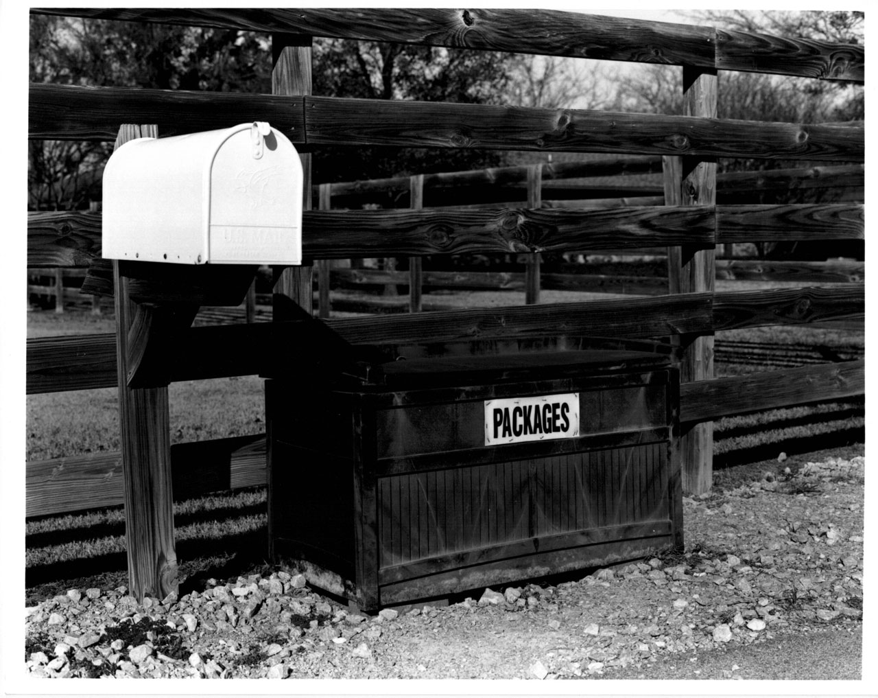

Shot a roll of FP4 (XTOL 1:1) and printed to 8x10. Brick wall test (low contrast) all the images look sharp from corner to corner at f3.5 through f11. The attached image is a high contrast scene shot at f8, printed to 8x10 and scanned on a flatbed at 300dpi. Note that the scan came out darker/contrastier than the actual print.
I'm thinking this lens is just fine and I'm gonna shoot it without reservation.
Thank you for all your comments.

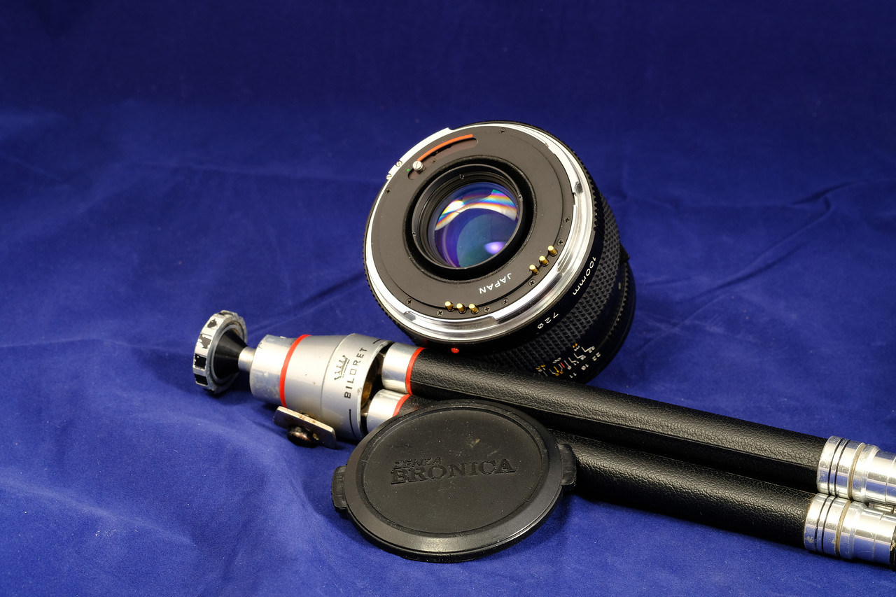

Odd... I've noticed other comments about their 100's. I bought some GS-1 gear some years back with 2 100's and one had separation. I had assumed it was damage by impact but perhaps this optic is prone to this? Here's my bad one:

I've never used it as I had the good one. Can't imagine it working very well, though.
