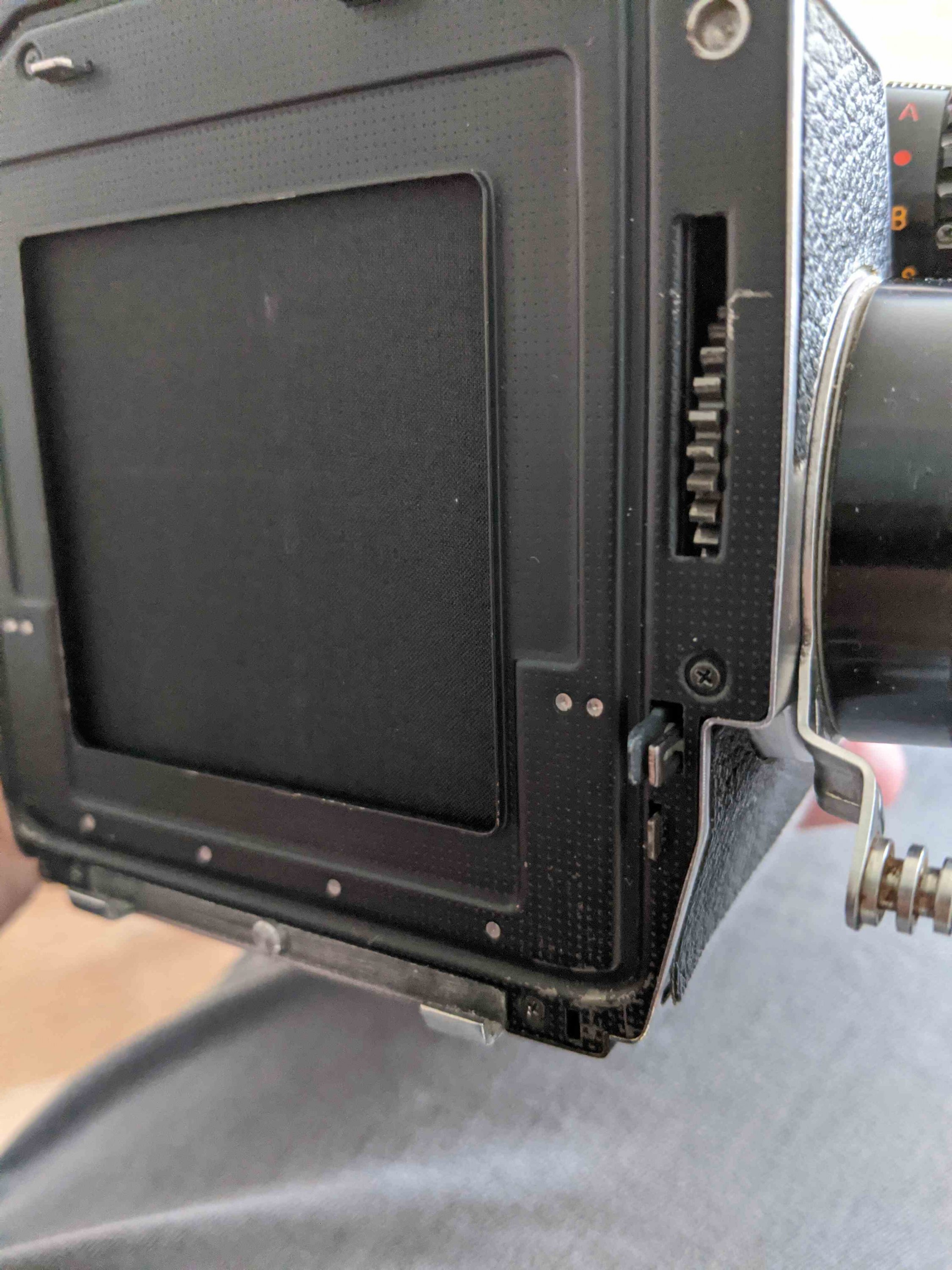

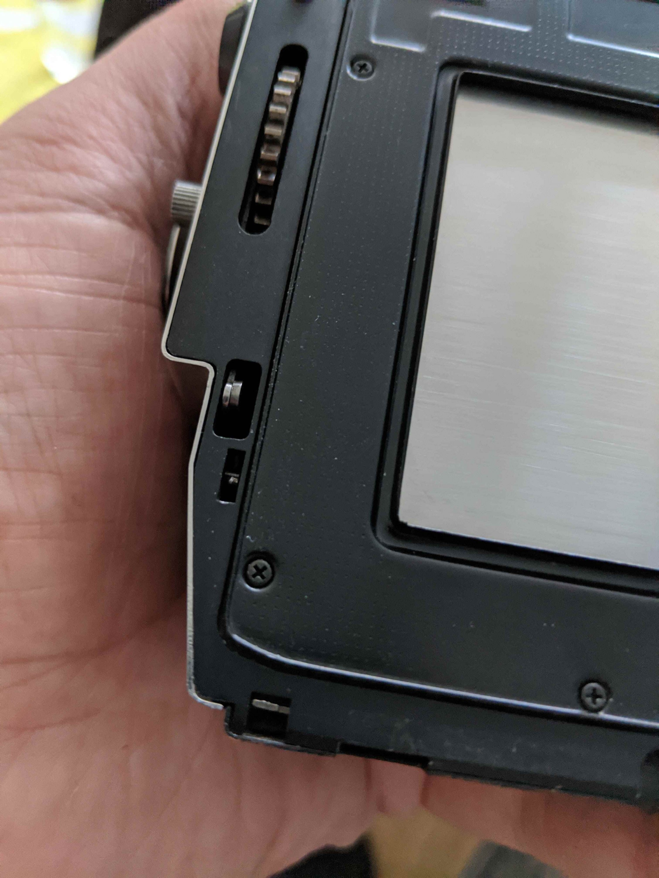

Another back came in the mail today. I was hoping for a working one, but it has almost the same issues like most of the other ones. Now I get the feeling it might be the EC-TL itself. (There is also one film back that works without all the double exposures but shoots on until frame 17 instead)
I noticed that the counter only increases when I hear the ticking noises that little break makes that keeps the takeup spool from rolling in the wrong direction. Side-note: The only working back does not have this break anymore. Has been broken since I have the camera.
Now I checked again what happens when shooting and the there are a few pins reaching from the camera into the back. And it seems that one or maybe two pins shoot out into the film back when the shutter is triggered.
Is there a chance that one pin pushes that thing below the one in the back that is moved out of the way when switched to double exposures and that does not happen every time?
I really would like to understand how this all works. I don't know if I would be able to fix it, but at the moment I don't know what might make sense. Maybe something is just a bit bend, but I don't see too much difference between all my film backs.
