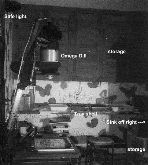

Boy oh boy do I ever need to find that hidden surveillance camera in my "darkroom"....

doc bob, what is up with that wall paper?
